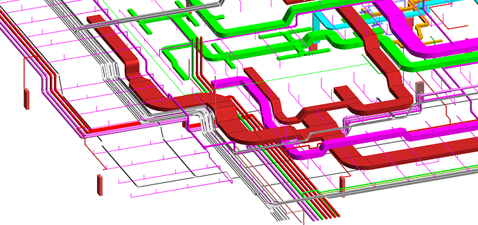

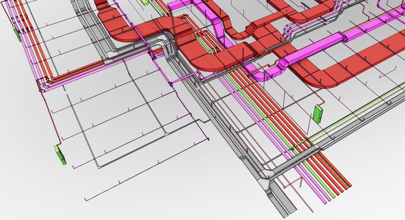

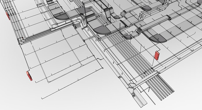

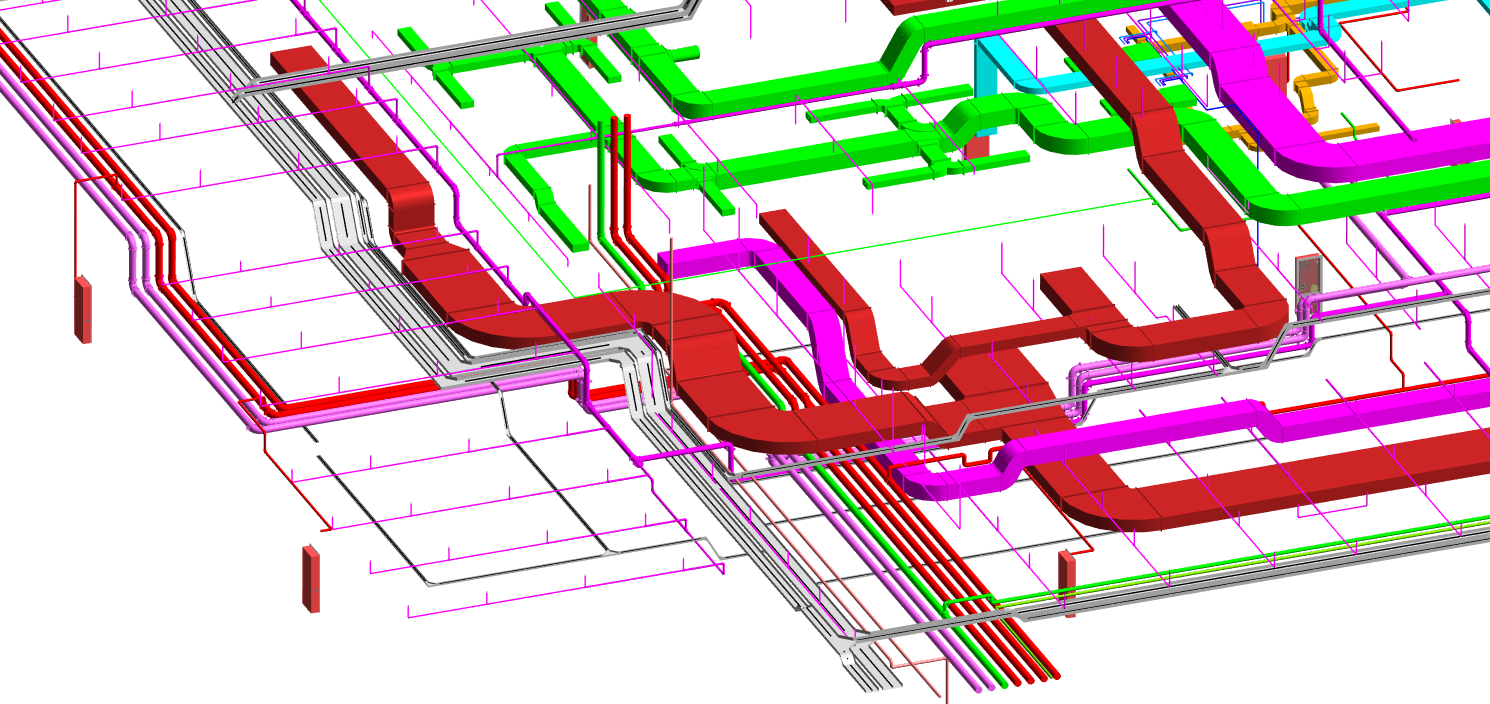

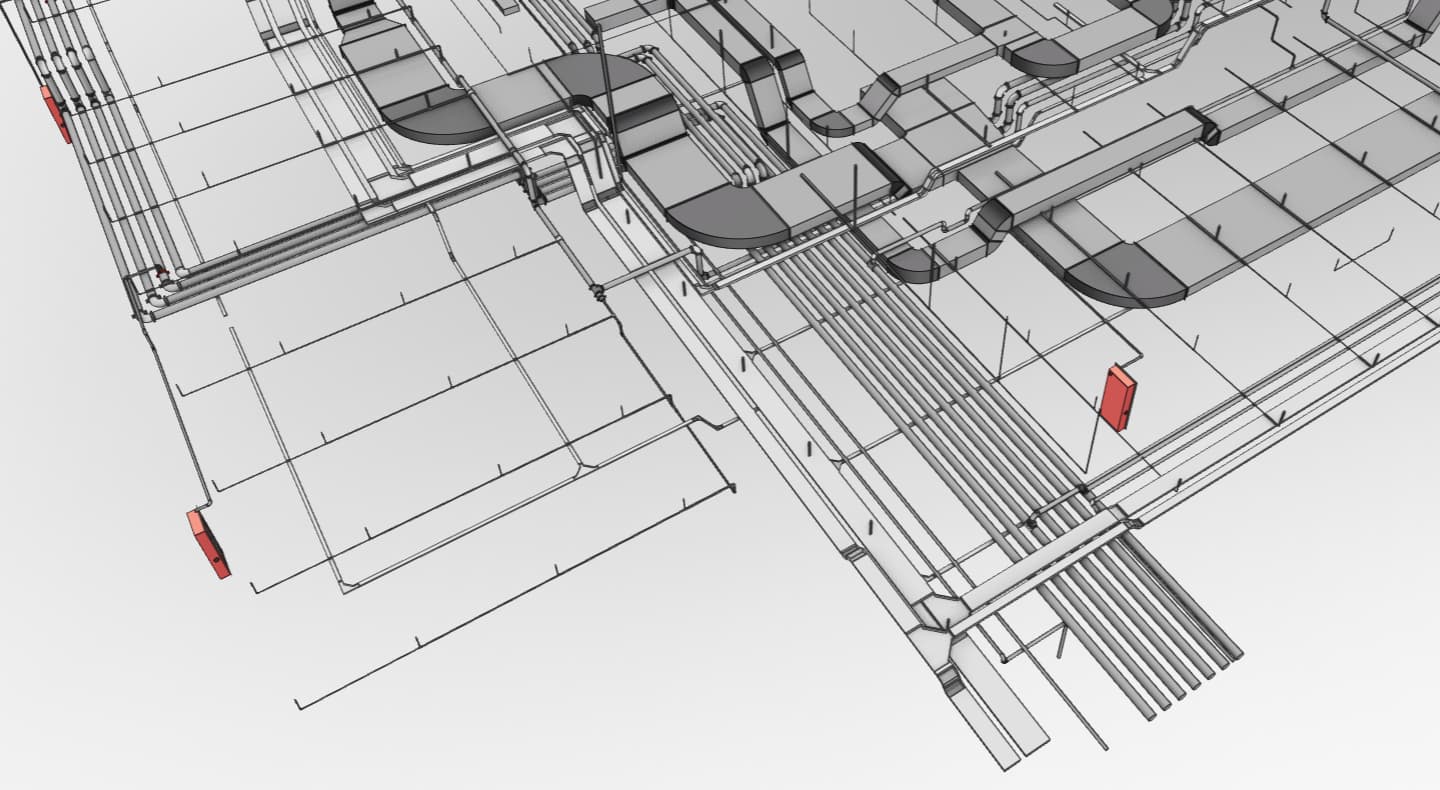

1.When creating MEP models, I often use the Duct System/Pipe System to assign material colors to my ducts and pipes for quick identification of different systems. When publishing using Revit Connector V2 or Navisworks Connector V3, these materials are retained. However, when I use Revit Connector V3, the materials no longer appear. Is this feature no longer supported, or did I miss some setting? :face_with_monocle:
↑in Revit
↑V2&Navisworks V3
↑Revit Connector V3

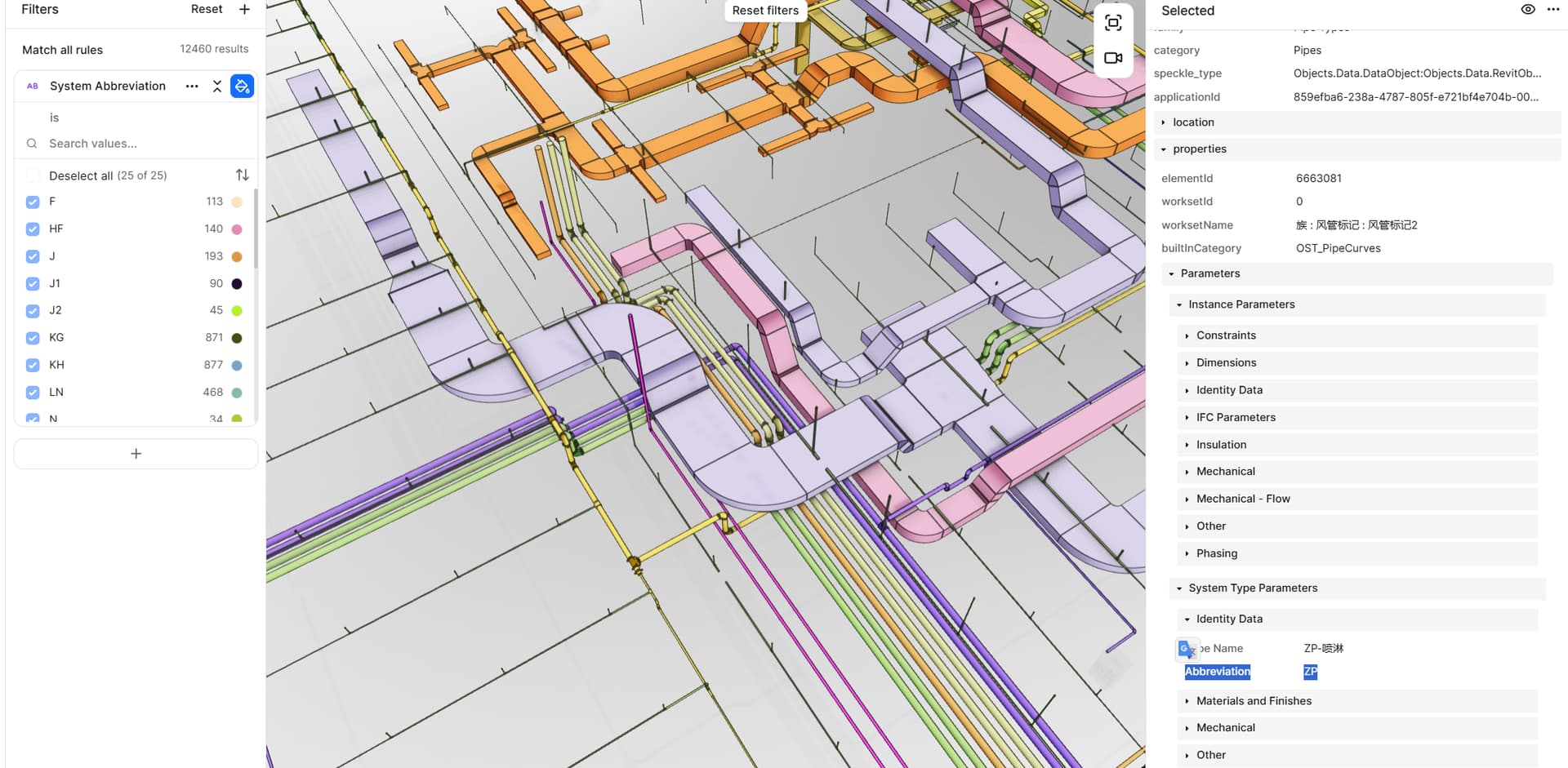

The filtering facility we have is designed to offer this functionality
Thank you for your reply. :grinning_face: May I ask if this feature allows modifying the corresponding colors and generating a fixed color scheme? In our MEP projects, we usually have a standardized color setup to improve communication efficiency.
Currently it does not.
We can add your company and future usage to an existing feature request if you provide details.
