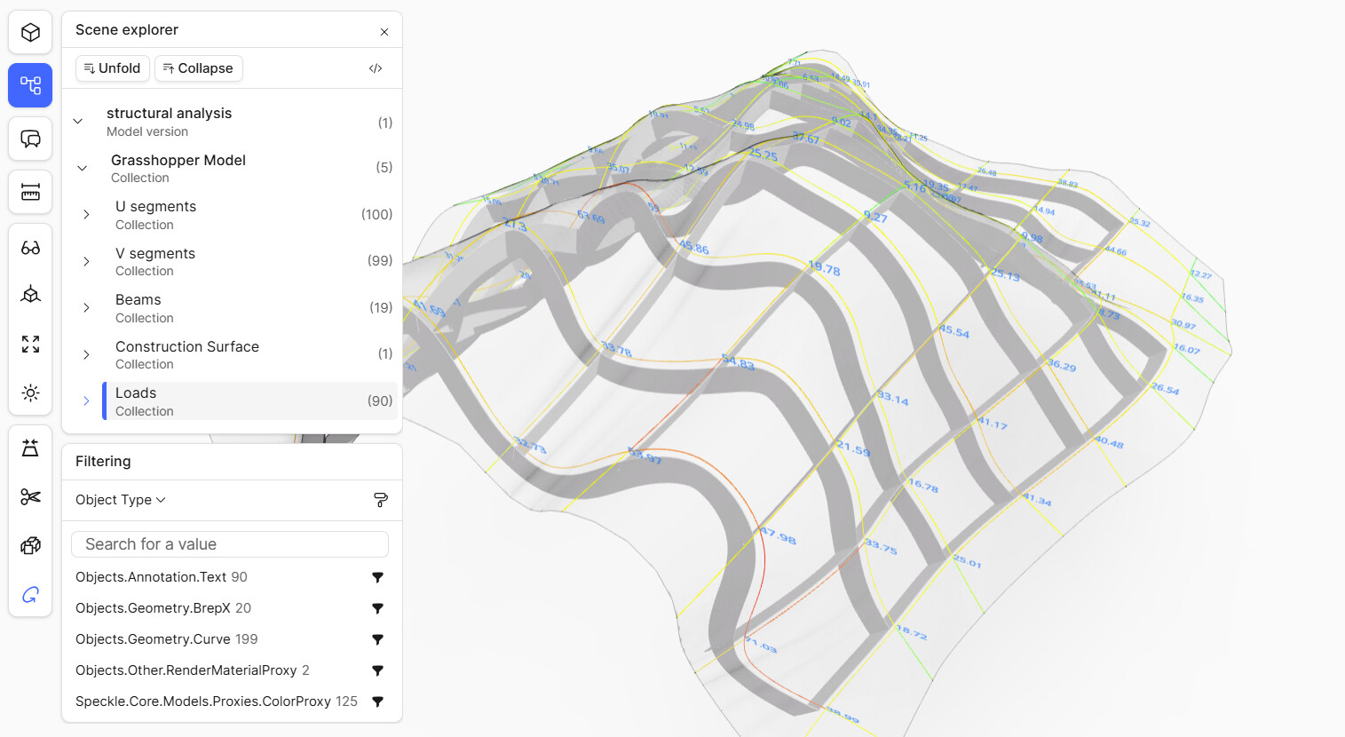

This is where Next-Gen connectors shine! Use Grasshopper to run calculations on your models and attach critical properties to objects for filtering in the viewer, building beautiful dashboards in PowerBI, or consuming in your own custom Speckle applications.
Online Presentation
Use passthrough nodes to easily assign colors and materials to geometry, so you can use our best-in-class viewer to share your computational geometry and analysis results.

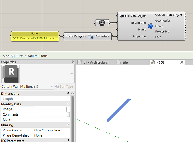

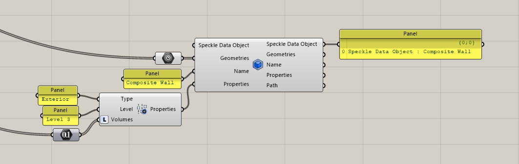

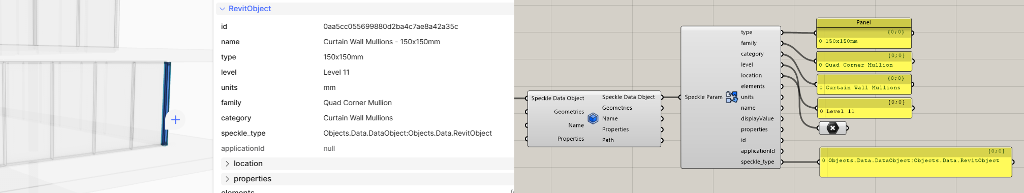

Now you can use the Speckle Data Object param to directly work with objects from these applications, which often represent more complex elements like Walls that can have multiple pieces of geometry associated with them.
  • Speckle Data Object passthrough node allows you to create or modify data objects
  • Using the Deconstruct node on your data object will expose all object fields that you can see with dev mode in the viewer.

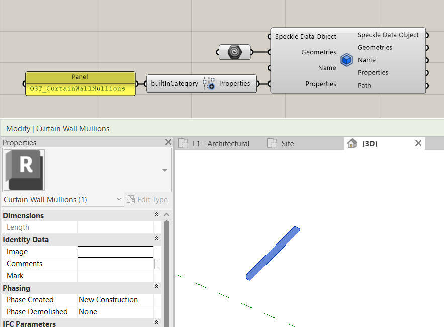

  • Want to load geometry in Revit with a specific category assigned? Just add a builtInCategory property with a revit category string value to your Speckle Data Object, and it will be loaded as a direct shape with that category

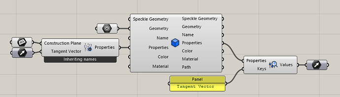

  • For Grasshopper ↔ Grasshopper aficionados, you can now add planes and vectors to the Properties on any Speckle Geometry.

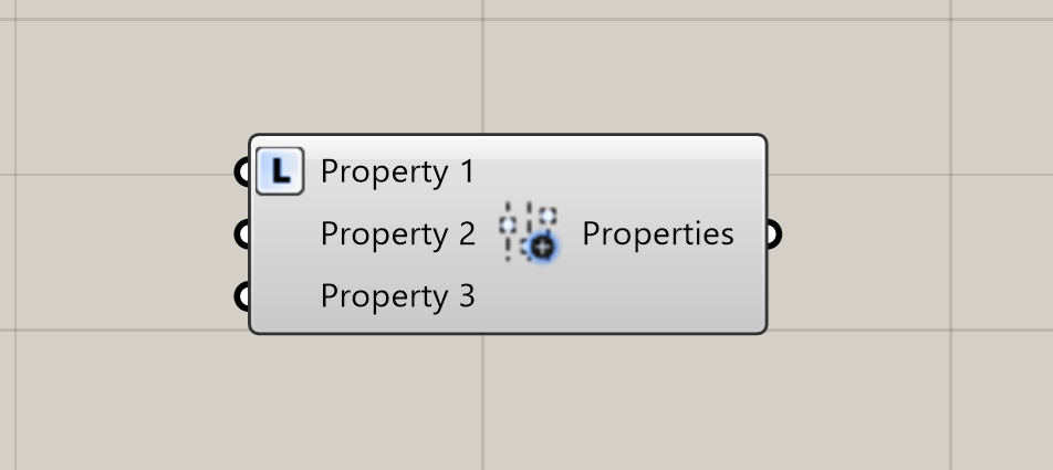

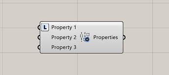

  • Create Properties node inputs now have a list access setting if you’d like to add list property values to objects.

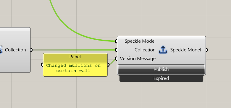

  • You can now add an optional version message when publishing a model.

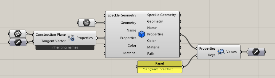

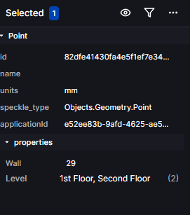

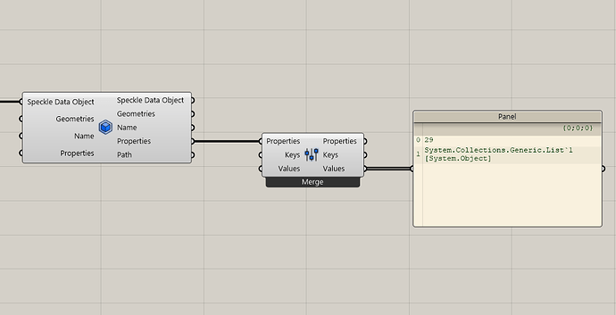

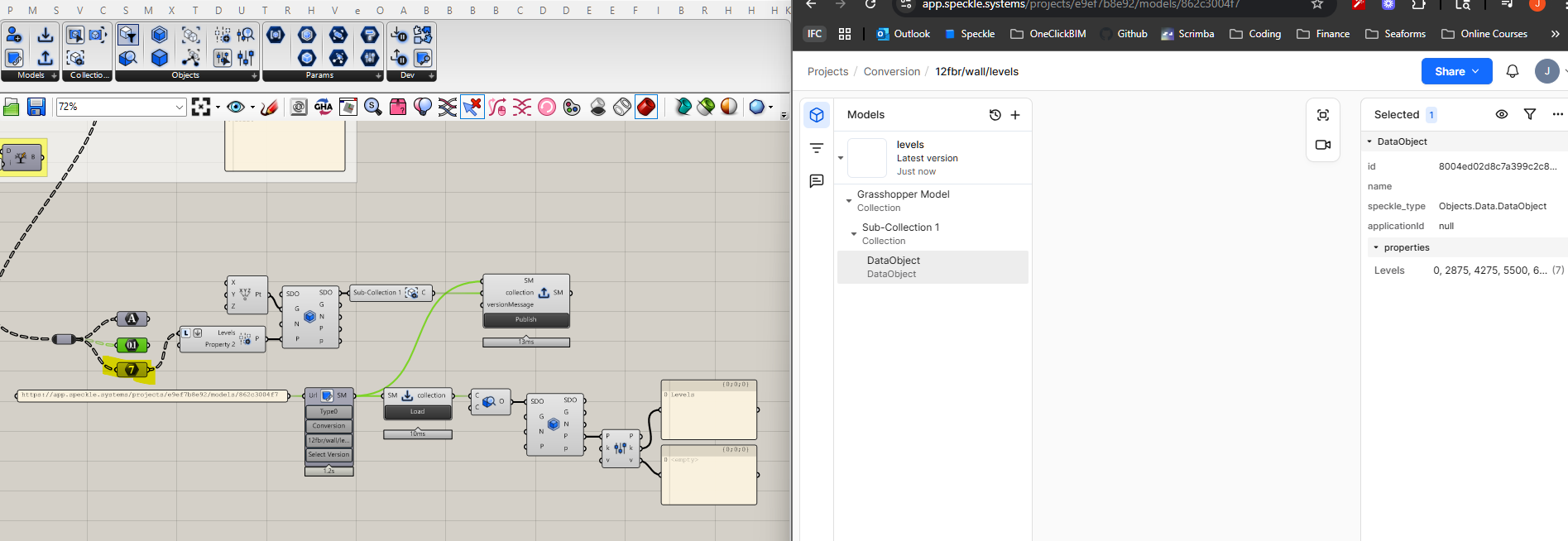

How can I output the list of value when i created properties with list?
Ray

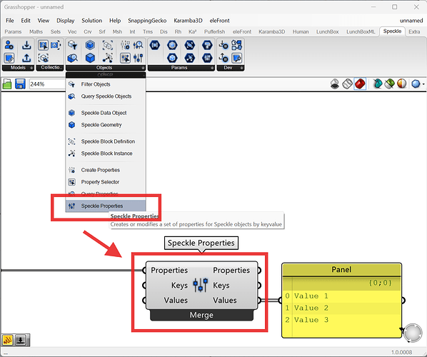

Hey @Ray_Yong,
You can use the Speckle Properties passthrough component.

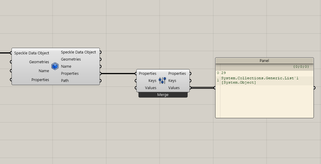

Hello @bjoern,
I tried, but it have a different result than yours.
It does show the list on speckle web.
Am i missing something here?
Ray

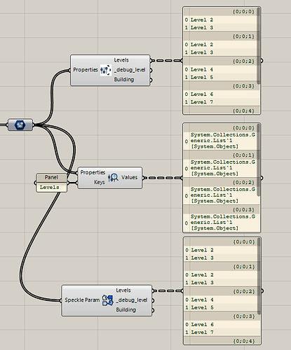

If i send string/number data in as a list, it gives me the “System.Collections.Generic.List”.
If I send integer data in as a list, it returns me empty.
Filed a bug report for this - most likely we were not accounting for list access in the passthrough node.
p.s. We’ve got quite a few GH tickets in the backlog, and should have some bandwidth to tackle them next week once we wrap up a bigger feature release - thanks for the reports in the meantime, we’ll get around to fixes as soon as we can!
Hi @Julius_Ang , @Ray_Yong,
Thanks for the reports on this. As @clrkng mentioned, we weren’t accounting for list access in the passthrough node. Having a mixture of prop types presented some challenges in keeping native access to, for example, lists.

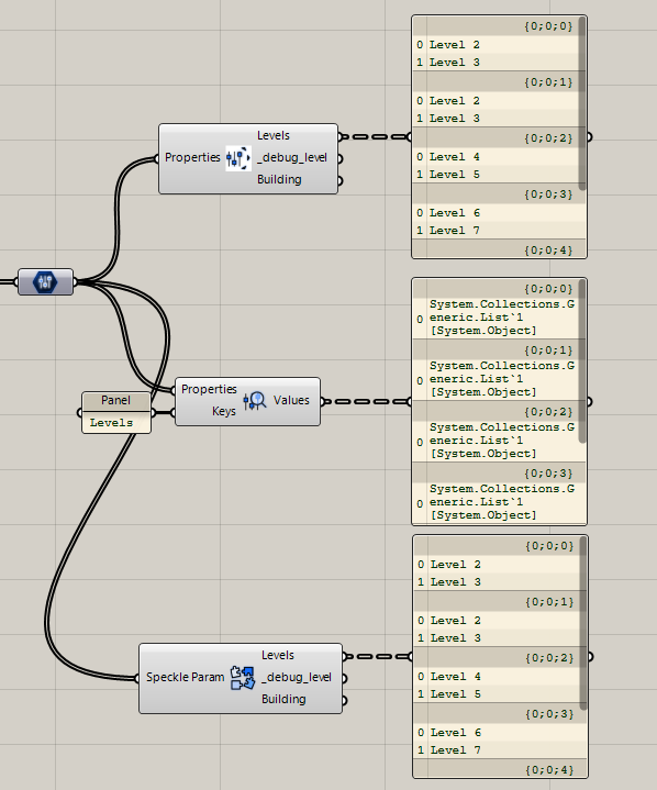

BUT, we have a solution! We’ve just released v3.8.2 which includes a Expand Properties component that dynamically outputs defined properties in a way that’s easier to work with. There is no change w.r.t. using a panel output on the passthrough node as gh doesn’t allow for this mixed-type behaviour in a single output. The below video illustrates using the deconstruct and new expand properties node to achieve the same result. Expand properties is obviously recommended in this case.
Let us know what you think of this!
Hey @bjoern, thanks for the bug fix, it works!
However, when i tried it with query properties, it still output the “generic List” thing.
It will be good if this also able to output a list.
But for now, i can work with the expand properties first.
Ray
Thanks for the feedback @Ray_Yong! I’ve fixed this and will be available with the next release - I’ll ping you once that’s in. Hoping the Expand Properties works sufficiently in the interim!

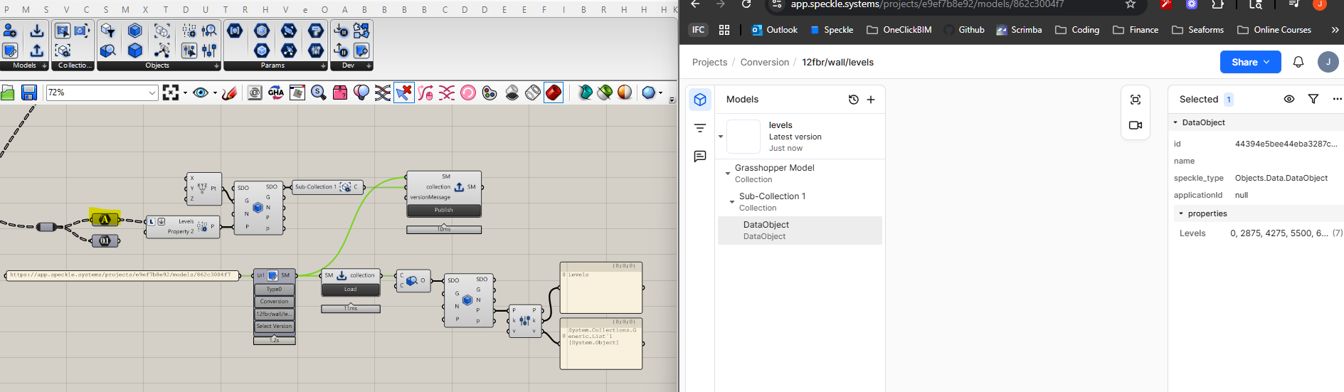

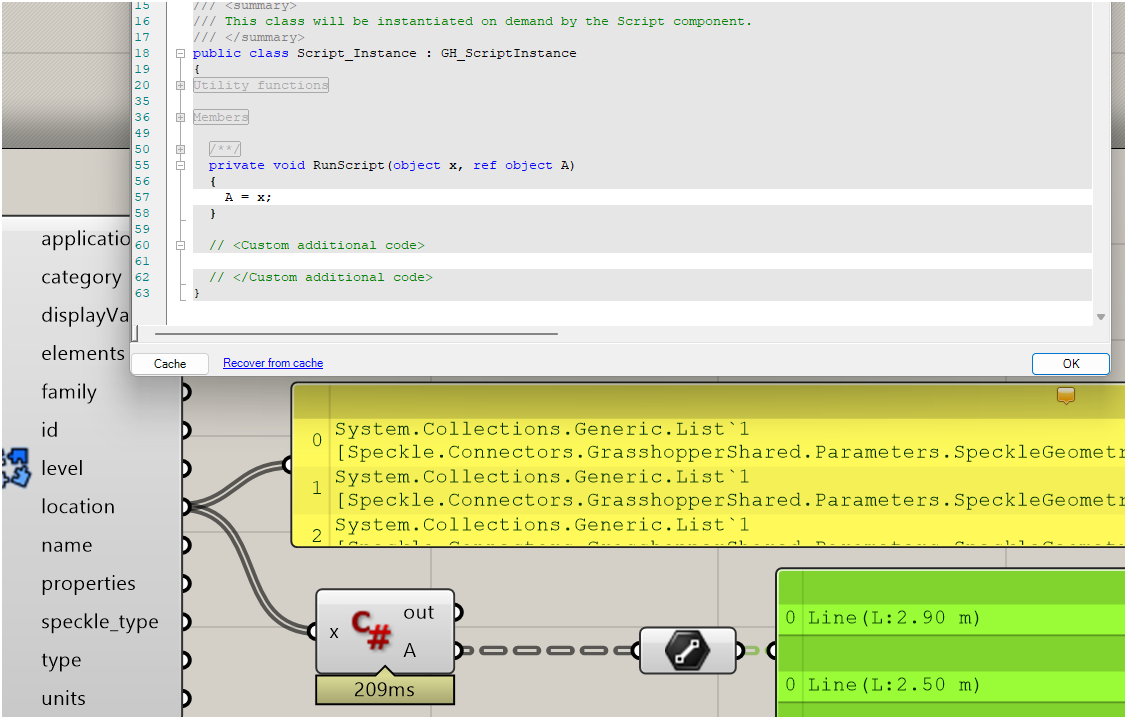

thanks @bjoern, one more thing, is there a way to retrieve properties like ID or appID, similar to the query properties. as in i can feed in the exact properties that i want to extract, instead of a deconstruct method?
i found out that the deconstruct component will changed based on the geometry it get, and when it change, it will disconnect the connection previously made. im currently using deconstruct component in an automation script with gh to retrieve appID and ID for diffing. and this deconstruct component is breaking the script most of the time.
Passing it through a c# component unwraps what I need (for now)
