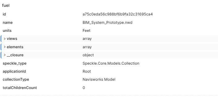

Hi All,
Hope you are doing well
Do you know where I can find the IfcGuid in my data ?
Have a nice day,
Mathilde

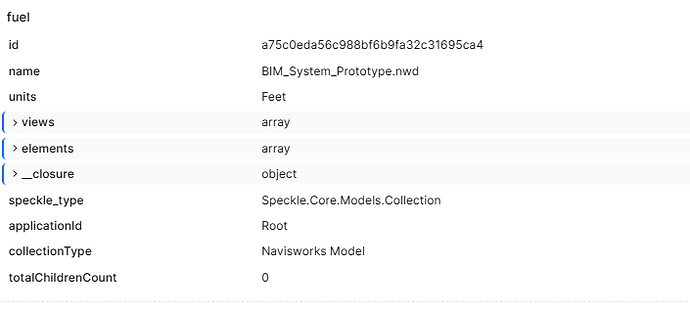

Hi All,
Have a nice day,
Mathilde
@Mathilde can you share a link to your model?
This looks like coming from Navis not Revit…
It’s my model : Multiple models - BIM SYSTEM PROTOTYPE | Speckle
@gokermu I shared the model, can you see it? I think do you remember it
@mirko.maccarronello & @Mathilde, I recommend you use the latest Next Gen version of the Navisworks connector.
Looking into what you have shared I suppose you have the interna properties option selected?
Great, thank you very much @jonathon. I had some problems with the latest version a few months ago, so I used 2.17, but now 2.21 works perfectly and we can see the IfcGUID.
