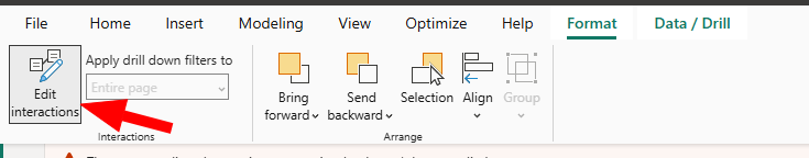

Hi!
I wanted to add a comment, in case it’s useful for someone.
Regarding the filtering, have you checked the interactions between visuals?
Through Format>Edit interactions
click on the table you want to use to filter your speckle visual, and check whether on the speckle visual which of the filtering options is applied.
You need the first one (Filter) and not the second one (Highlight)
Tables by default only highlight the visual.
Thank you so much @Anastasia, that’s a great contribution you just commented! :tada::tada::tada:
