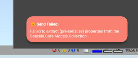

Failed to extract (pre-realize) properties from the Speckle.Core.Models.Collection
Hey,
I am trying to send partial MEP model from Navisworks Manager 2025 to speckle(own deployment), progress goes up to 100% and then get this error.
previously i have tried sending other parts of the model and all seems to send just fine.
Navisworks connector version: 2.21.3
Speckle Manager version: 2.15.1
Screenshot 2025-02-19 104925 (5)
I recommend installing the v3 Navisworks connector, which is available here: speckle-releases. It should also be installed alongside the v2 connector since v2.21.
It represents all the learnings from the Alpha version of Navisworks connector and leverages even greater performance.
It should be compatible with your server deployment, but it is always advisable to keep up to date.
