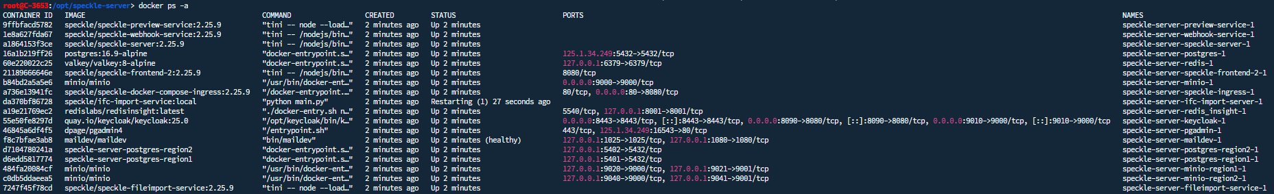

Currently, there is an error involving two import services, “fileimport-service” and “ifc-import-server”, for which we have not found a solution. This occurs when trying to import a file by dragging it onto the project (it works correctly with connectors).
The error that appears in the logs (speckle-server, fileimport-service) is the following:
WARN [10:24:42.611]: Error while processing file upload. {"component":"file-uploads","streamId":"015ad9a06c","projectId":"015ad9a06c","uploadId":"81fcdd21d3","modelId":"38ad953f0d","branchId":"38ad953f0d","branchName":"test import","fileImportDetails":{"id":"81fcdd21d3","streamId":"015ad9a06c","branchName":"test import","userId":"8c2e42a596","fileName":"test.ifc","fileType":"ifc","fileSize":24656663,"uploadComplete":true,"uploadDate":"2025-09-16T10:24:09.698Z","convertedStatus":3,"convertedLastUpdate":"2025-09-16T10:24:42.545Z","convertedMessage":"503 Server Error: Service Unavailable for url: http://speckle-server:3000/api/diff/015ad9a06c","convertedCommitId":null,"modelId":"38ad953f0d","performanceData":null}}

and the logs of “ifc-import-server”:
{"message": "[Errno -3] Temporary failure in name resolution", "@mt": "Execution failed with exception: {message}", "@t": "2025-09-15T14:50:56.250504Z", "@x": "Traceback (most recent call last):\n  File \"/app/main.py\", line 60, in main\n    await task\n  File \"/app/lib/python3.13/site-packages/ifc_importer/job_processor.py\", line 75, in job_processor\n    connection = await setup_connection()\n                 ^^^^^^^^^^^^^^^^^^^^^^^^\n  File \"/app/lib/python3.13/site-packages/ifc_importer/repository.py\", line 10, in setup_connection\n    connection = await connect(settings.fileimport_queue_postgres_url)\n                 ^^^^^^^^^^^^^^^^^^^^^^^^^^^^^^^^^^^^^^^^^^^^^^^^^^^^^\n  File \"/app/lib/python3.13/site-packages/asyncpg/connection.py\", line 2421, in connect\n    return await connect_utils._connect(\n           ^^^^^^^^^^^^^^^^^^^^^^^^^^^^^\n    ...<20 lines>...\n    )\n    ^\n  File \"/app/lib/python3.13/site-packages/asyncpg/connect_utils.py\", line 1075, in _connect\n    raise last_error or exceptions.TargetServerAttributeNotMatched(\n    ...<2 lines>...\n    )\n  File \"/app/lib/python3.13/site-packages/asyncpg/connect_utils.py\", line 1049, in _connect\n    conn = await _connect_addr(\n           ^^^^^^^^^^^^^^^^^^^^\n    ...<6 lines>...\n    )\n    ^\n  File \"/app/lib/python3.13/site-packages/asyncpg/connect_utils.py\", line 886, in _connect_addr\n    return await __connect_addr(params, True, *args)\n           ^^^^^^^^^^^^^^^^^^^^^^^^^^^^^^^^^^^^^^^^^\n  File \"/app/lib/python3.13/site-packages/asyncpg/connect_utils.py\", line 931, in __connect_addr\n    tr, pr = await connector\n             ^^^^^^^^^^^^^^^\n  File \"/app/lib/python3.13/site-packages/asyncpg/connect_utils.py\", line 802, in _create_ssl_connection\n    tr, pr = await loop.create_connection(\n             ^^^^^^^^^^^^^^^^^^^^^^^^^^^^^\n    ...<2 lines>...\n        host, port)\n        ^^^^^^^^^^^\n  File \"/usr/local/lib/python3.13/asyncio/base_events.py\", line 1122, in create_connection\n    infos = await self._ensure_resolved(\n            ^^^^^^^^^^^^^^^^^^^^^^^^^^^^\n        (host, port), family=family,\n        ^^^^^^^^^^^^^^^^^^^^^^^^^^^^\n        type=socket.SOCK_STREAM, proto=proto, flags=flags, loop=self)\n        ^^^^^^^^^^^^^^^^^^^^^^^^^^^^^^^^^^^^^^^^^^^^^^^^^^^^^^^^^^^^^\n  File \"/usr/local/lib/python3.13/asyncio/base_events.py\", line 1508, in _ensure_resolved\n    return await loop.getaddrinfo(host, port, family=family, type=type,\n           ^^^^^^^^^^^^^^^^^^^^^^^^^^^^^^^^^^^^^^^^^^^^^^^^^^^^^^^^^^^^\n                                  proto=proto, flags=flags)\n                                  ^^^^^^^^^^^^^^^^^^^^^^^^^\n  File \"/usr/local/lib/python3.13/asyncio/base_events.py\", line 939, in getaddrinfo\n    return await self.run_in_executor(\n           ^^^^^^^^^^^^^^^^^^^^^^^^^^^\n        None, getaddr_func, host, port, family, type, proto, flags)\n        ^^^^^^^^^^^^^^^^^^^^^^^^^^^^^^^^^^^^^^^^^^^^^^^^^^^^^^^^^^^\n  File \"/usr/local/lib/python3.13/concurrent/futures/thread.py\", line 59, in run\n    result = self.fn(*self.args, **self.kwargs)\n  File \"/usr/local/lib/python3.13/socket.py\", line 977, in getaddrinfo\n    for res in _socket.getaddrinfo(host, port, family, type, proto, flags):\n               ~~~~~~~~~~~~~~~~~~~^^^^^^^^^^^^^^^^^^^^^^^^^^^^^^^^^^^^^^^^\nsocket.gaierror: [Errno -3] Temporary failure in name resolution", "@l": "error"}

I attach the compose files also.

After running the services docker ps -a displays the following:
Could you please help us identify the cause of this issue or guide us towards a possible solution?
Thank you in advance.
