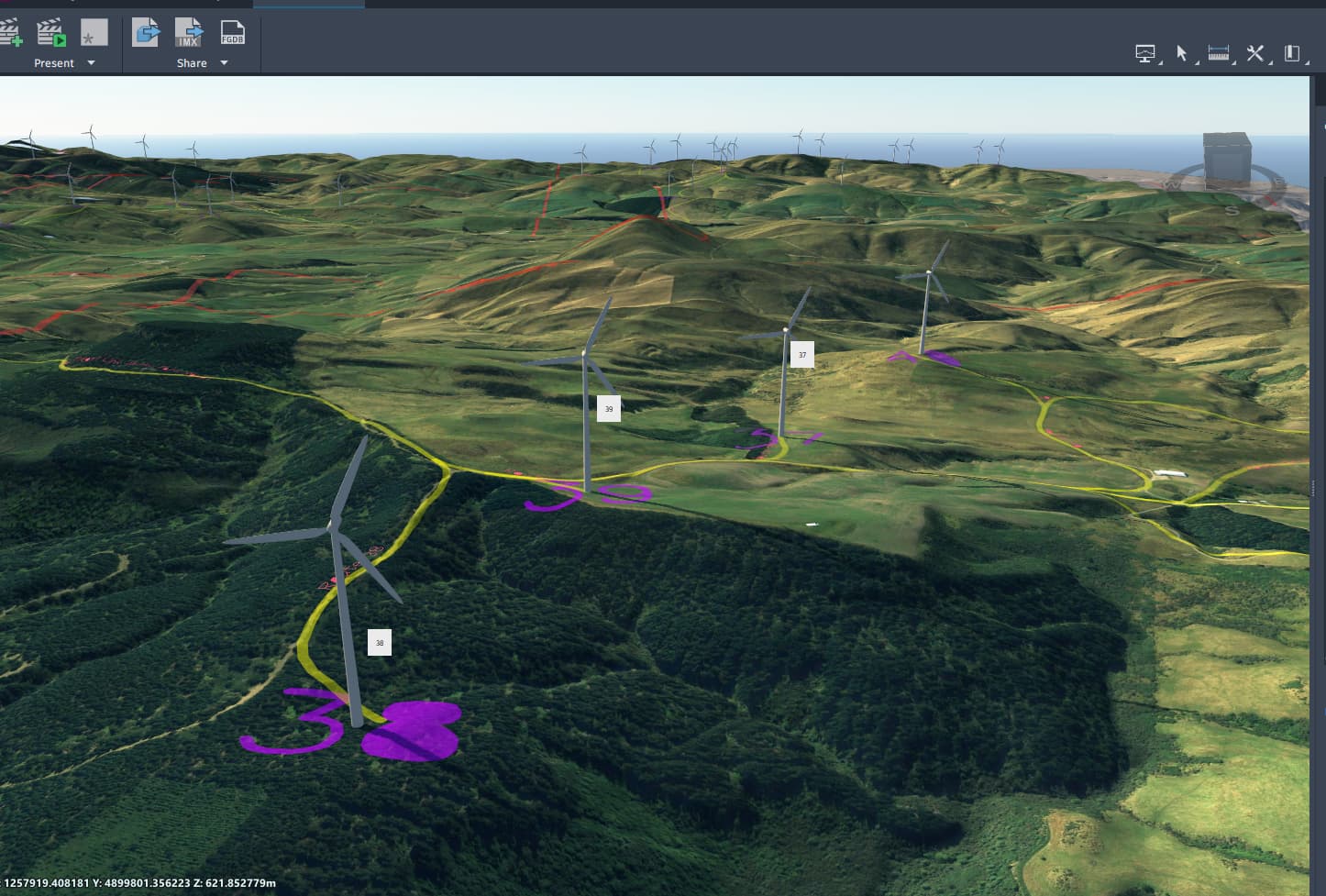

Currently what my Infraworks model looks like, goal is to make Speckle model to a similar level of detail.

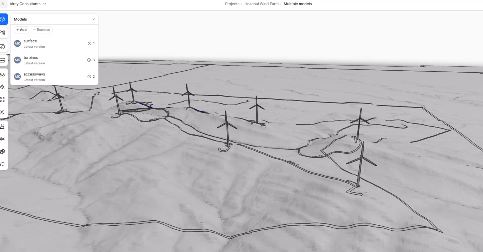

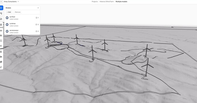

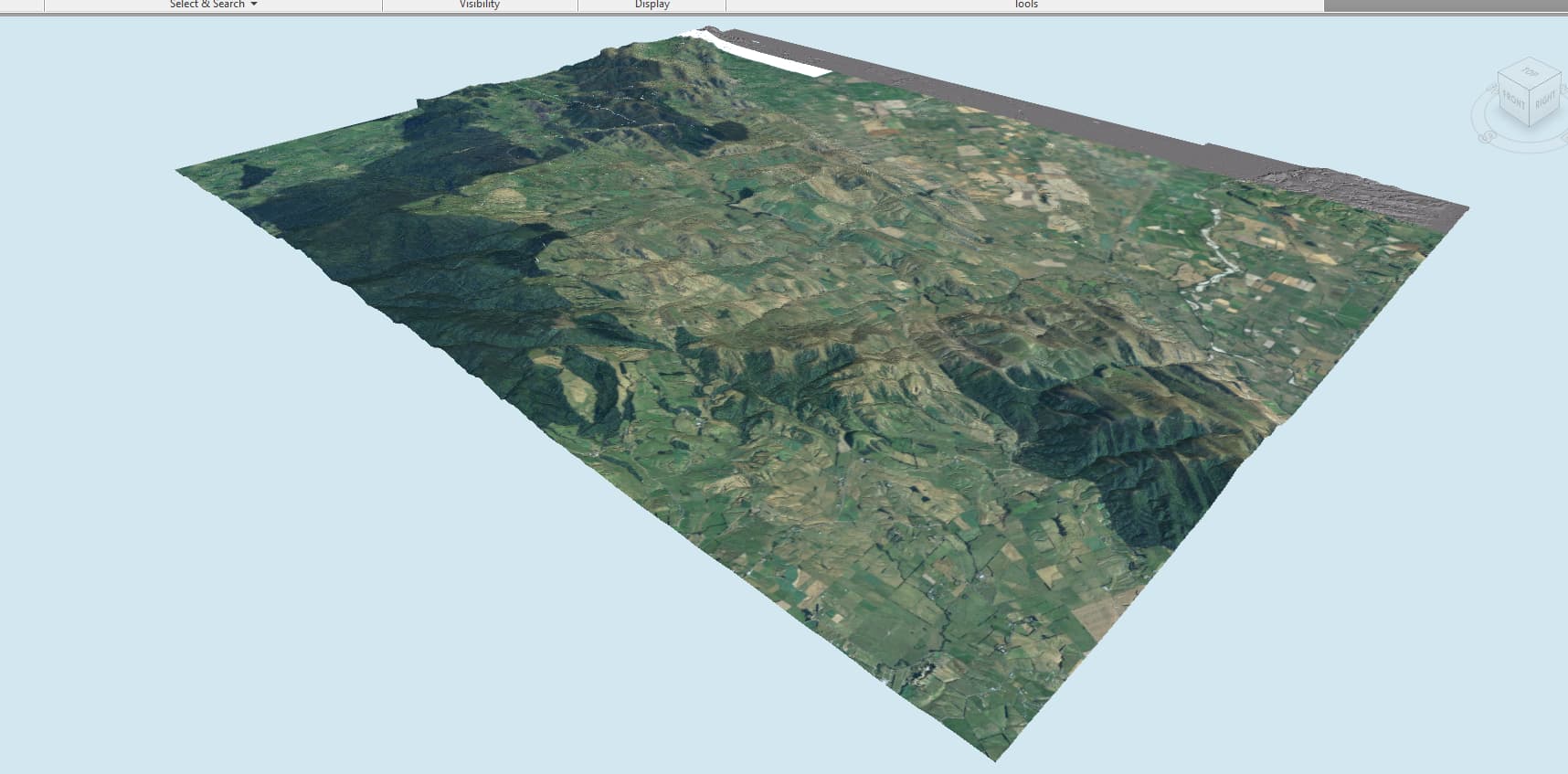

Thanks for clarifying that. I decided to have another go by overlaying texture onto my surface before uploading to Speckle.
At first it looked like it was working at first when the surface is loading, but when it has finished loading it just reverts back to grey with some linework only.
Workflow I am currently attempting. Infraworks > Navisworks > upload to Speckle via connector.

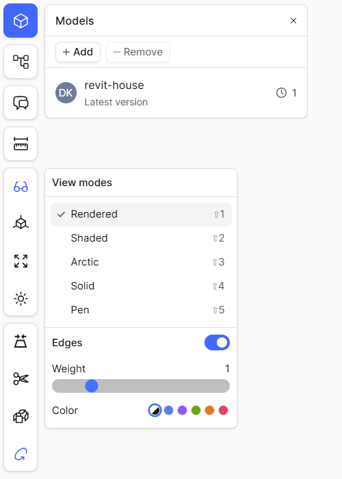

Ah, by any chance are you looking for colors instead of textures?
Could you try changing your view mode in the viewer to Shaded and see if any colors render for you?

Do you know why this workflow is not currently working for me? The data I am trying to upload is an .fbx file via the Navisworks connector and is 250MB, so maybe too large?
Hi Mike, we do not support uploading textures from our connectors, or rendering textures in the viewer. That is why you aren’t able to see the aerial image that you see in Navis.
hmm… are you able to clarify what the render view can do? Hovering over the icon it says “A realistic view of your model rendered with available materials for surfaces”. Can I not make the aerial be that available material?
Navisworks doesn’t send the aerial image, a bitmap texture on fbx, so there’s nothing for the viewer to render. As @clrkng has stated, texture materials are not supported.
