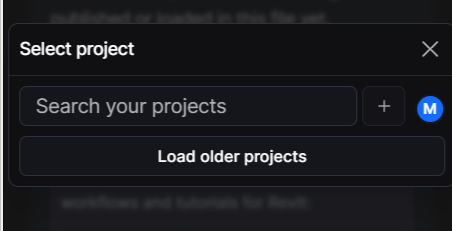

Hello all,
I would like to test the connectors version 3.8.2, but I have the same issue in Revit and Autocad. Also if I’m connected I can’t search my speckle projects or create a new one, in publish and load
Any idea?

Has it been a while since you used Speckle on Desktop?
You could try nuking the Accounts.db in %APPDATA%/Roaming/Speckle - then restarting Revit
This will force the need to reauthenticate via the v3 connector once back in revit
