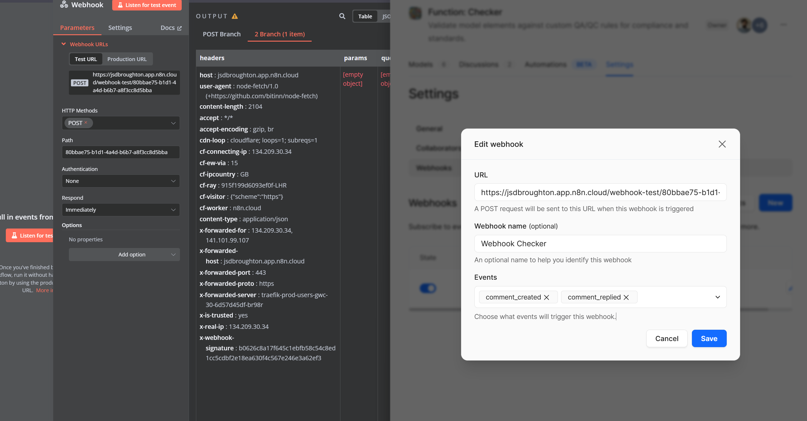

I’m having trouble with the webhook trigger. I’m not getting any response from it. I have set the HTTP method to POST and pasted the Speckle webhook URL. Additionally, I have enabled my model to be viewed by anyone.Could you please explain where I might have gone wrong?
which trigger did you enable? where are you listening to the speckle webhook call?
I tried using a webhook as a trigger in my n8n workflow, but I’m not getting any response even after following up. Could you please show me how to get a response from the webhook inside the n8n workflow? I’m trying to deploy an agent model to chat with model values.
can you confirm the webhook is firing with the payload you are expecting - i always use webhooks.site for this - super handy
yes, I tried !
i see so you need help consuming the webhook payload and making a query for the data from Speckle it relates to.
Are you able to screen grab your n8n flow ? and what you have already tried?
