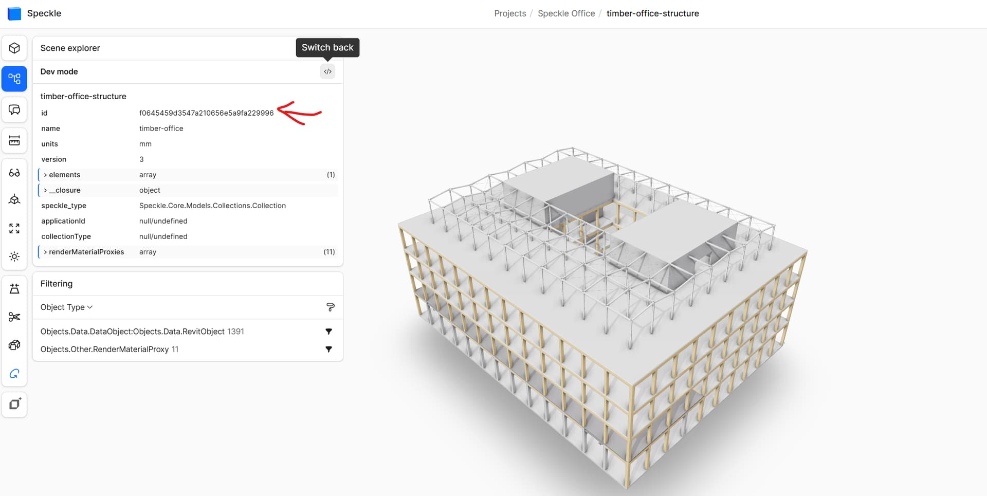

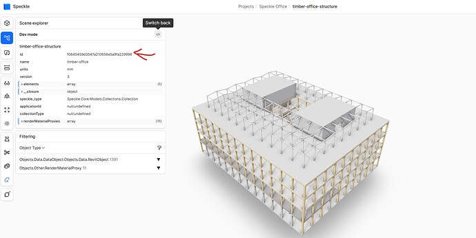

You need to specify the object ID because you need to specify the Object that you want to query. If you want to Query the whole model (ie query all the objects) - then you will need to specify the Root Object ID.
The Root Object ID you can easaly find it by clicking the Dev Mode(without selecting anything) in the 3D Viewer.

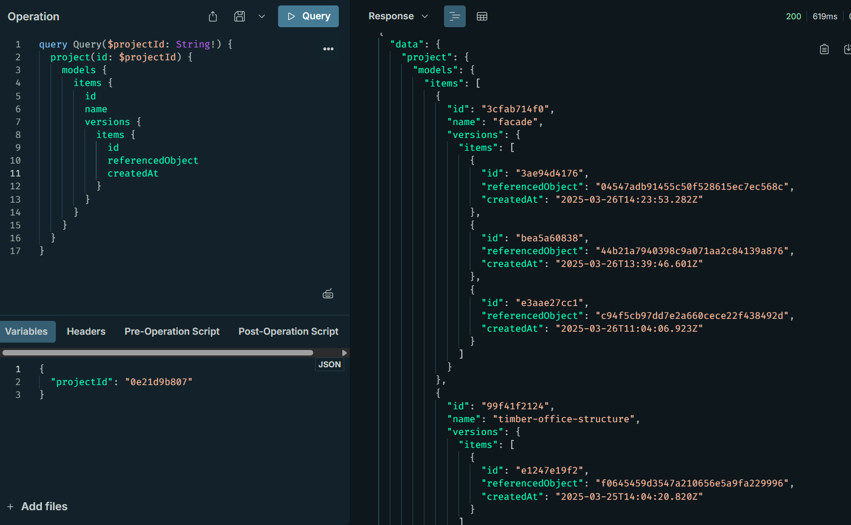

The other way to get the Root Object ID (aka referencedObject) is by quering the Project that holds your models like below.
You simple query the Project to find what Models and Versions exists - then you pick the latests (or whatever version you like).

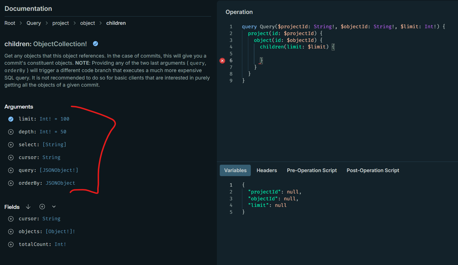

Lastly, using GQL API you will need to specify a limit - by defult is 100, this means that it will return 100 objects. You can also specify the Depth, in order to query Nested objects. One object can have multiple nested objects.
