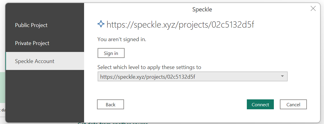

  2. the URL you are using is the old one, please use the new format https://app.speckle.systems/projects/02c5132d5f

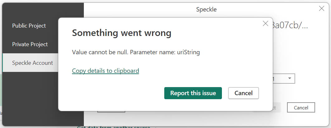

Hi @teocomi
I’ve installed and registered the latest version of the connector, but I couldn’t sign in to Speckle in Power BI.

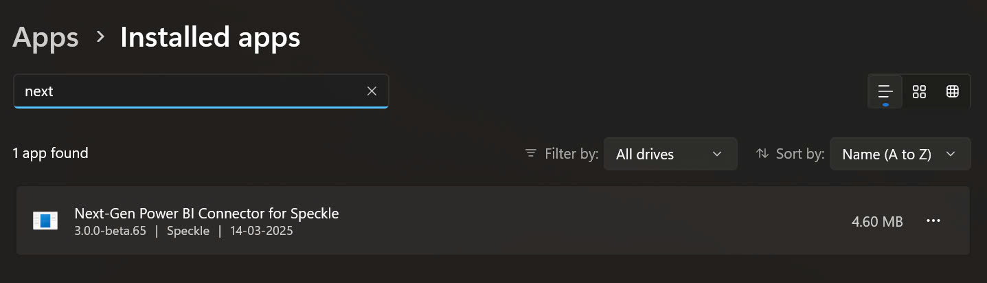

I have a guess. But before that could you validate for me that you are on latest version (3.0.0-beta.65) of Next-Gen Power BI Connector for Speckle by checking from Installed apps as below.
Hi @oguzhan
I’ve already checked the version,and it is the same as the one you showed.

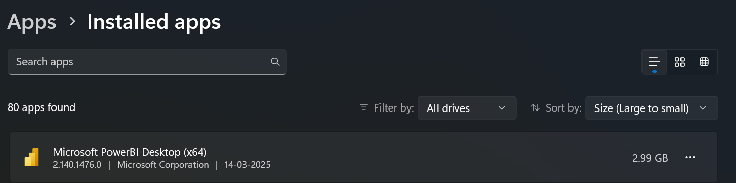

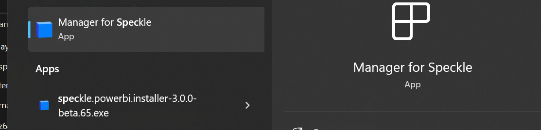

I meant from Installed Apps not from the Windows Search. Because what you showed me is the executable - not the installed application itself.
  • Search for Installed Apps
  • Search for Next-Gen Power BI Connector for Speckle
  • Post screenshot here

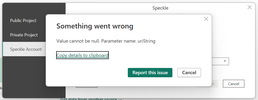

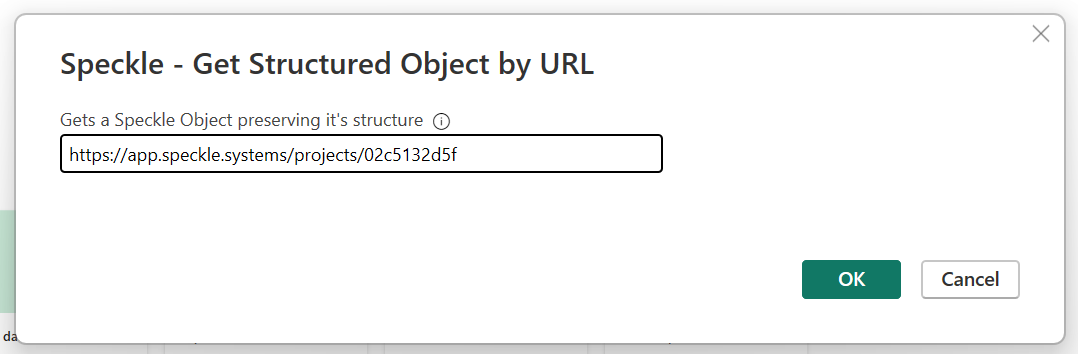

@dogukan my guess is @Trung535 has quite old version of next gen powerbi because of this screenshot. I believe we do not have [Structured] Get Data way anymore
Hi @oguzhan
I am sending you the screenshot. Thank you for your support!

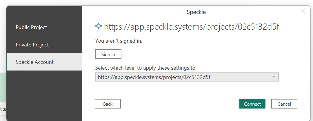

I do not know why you see old Get Data methods. I would expect to see it as below

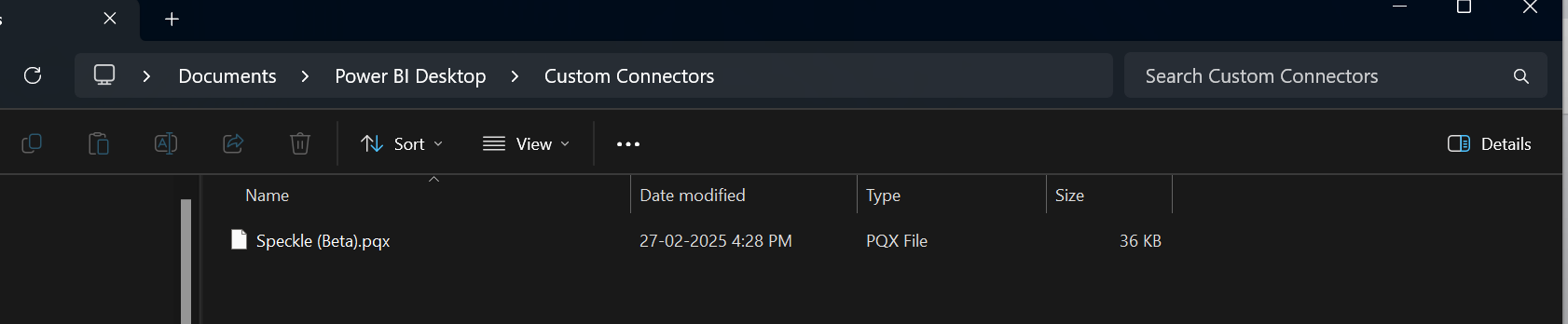

Could you also share screenshot from Documents/Power BI Desktop/Custom Connectors?
Hi @oguzhan
I send it.
Hi @oguzhan
The difference is Speckle.qpx. Can you send me the Speckle.Mez. I try it again

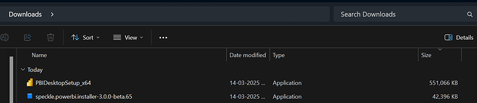

Let’s be safe, you can delete these files and then please try to download it from here and install the executable after download. It seems to me your local setup is borked for some reason.
Hi @oguzhan,
I’ve already downloaded and installs the last version of both power BI and the Speckle connector, but it still gives an error.

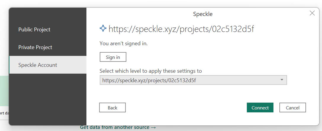

Are you able to see above now instead below?
I am happy to jump on a call btw. Let me know if it works for you
Yes Sir, I’m seeing above right now. (The picture)
