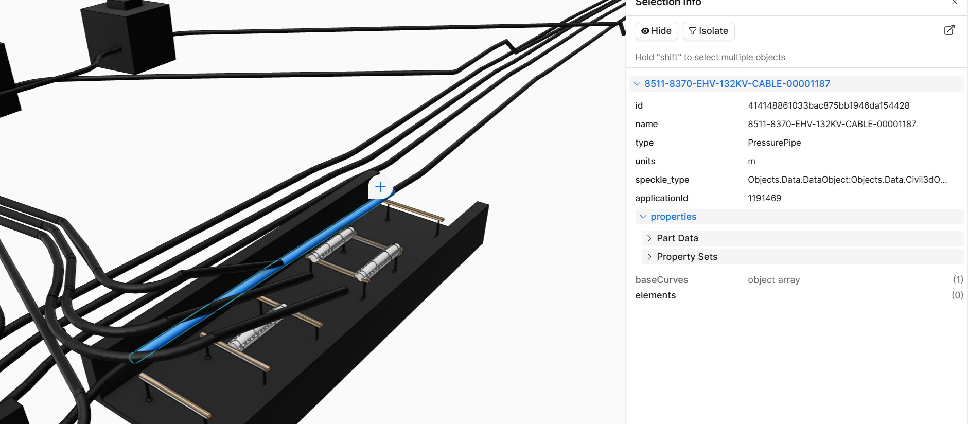

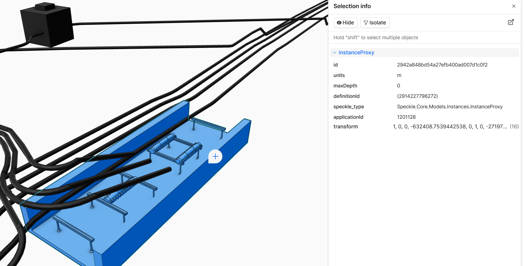

I converted a file from C3D to Speckle that contained Pipes + Structures + 3D Solid in blocks.
after checking the file in Speckle Web :
All Pipes + Structure has the proprty sets
All 3D Solids have not any proprty sets
https://app.speckle.systems/projects/4313ce26f5/models/3d80e3f366
Pipes
3D Solids

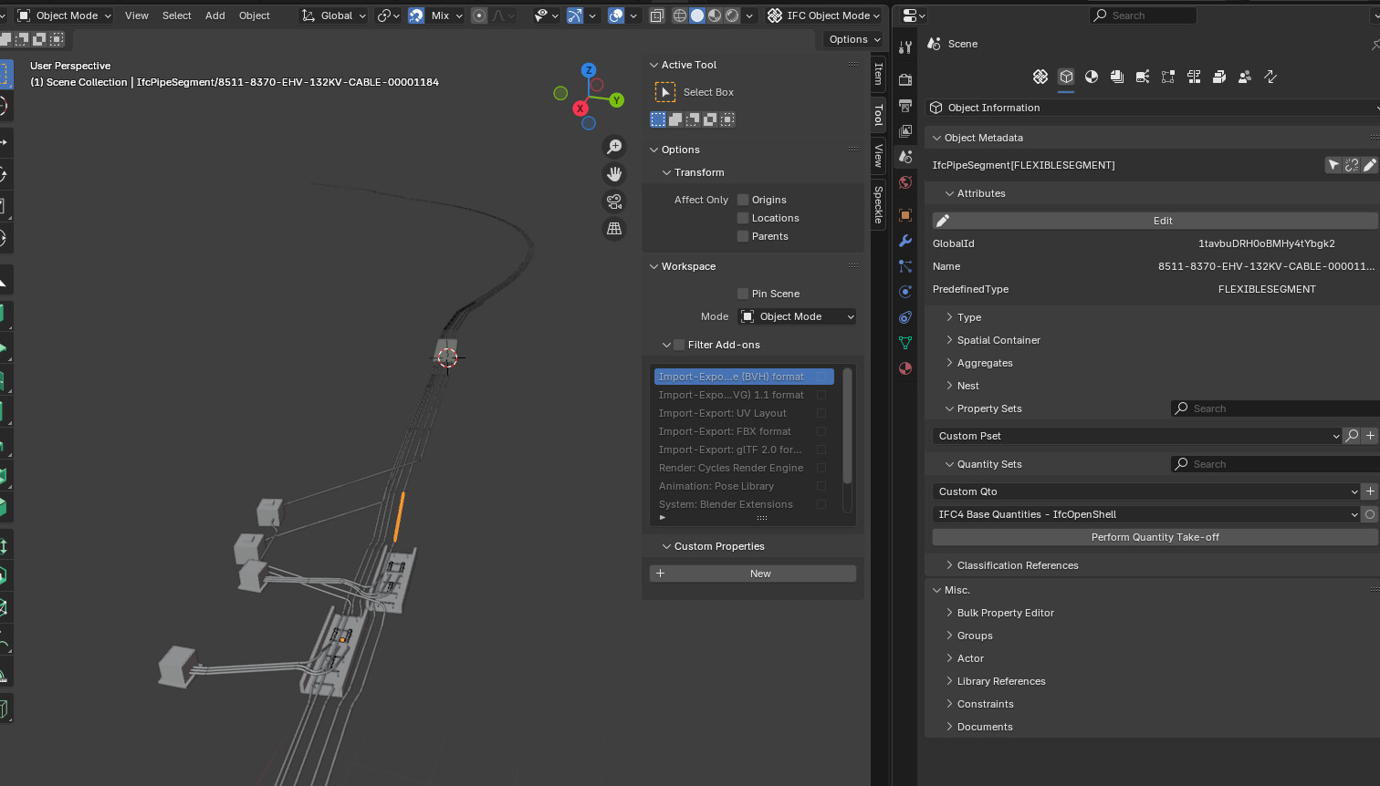

after that I loaded the project into Blender,
No proprty sets have been loaded for pipes or 3D Solids
So, there 2 issues ( one in Speckle , second in blender )
Any help please ?
Starting with the latter first, the lack of properties in Blender is expected behaviour; we aren’t transmitting properties between applications in almost all cases. I have flagged it in our systems as a feature request.
Regarding the 3D solids with properties, I can see that you are right in your observation, but I don’t have sight of the original model, so I don’t know if there is an issue to rectify. If possible, please share something with us - it can be a minimal set of information in Civil3D.
Thanks for your reply,
File is attached.
Civil 3D.dwg (8.0 MB)
Thanks - I have added this to the bug report.
