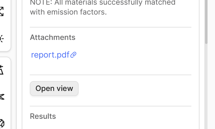

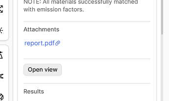

When you are making new models, there is another helper function that is handy
def set_context_view(
        self,
        # f"{model_id}@{version_id} or {model_id} "
        resource_ids: Optional[List[str]] = None,
        include_source_model_version: bool = True,
    ) -> None
This allows an automation resultant model to be viewed side by side in a federated view alongside the original. Very pertinent to analysis mesh results.
