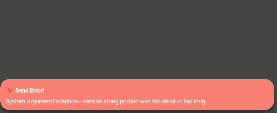

I’m getting
For the V3 connector I’m getting

The “Version string portion was too short or too long” error is occurring because your server is reporting a version that is is not a valid semver.
You can see what the server does return by going to /graphql and testing this query
query ServerInfo {
  serverInfo {
    version
You should see it return a semver like 2.25.4 or 2.25.5-alpha.409268
dev would also be considered a valid value.
an empty string would be considered invalid, as would anything else that isn’t a valid semver.
If you’re using our docker images, this should already be configured for you.
