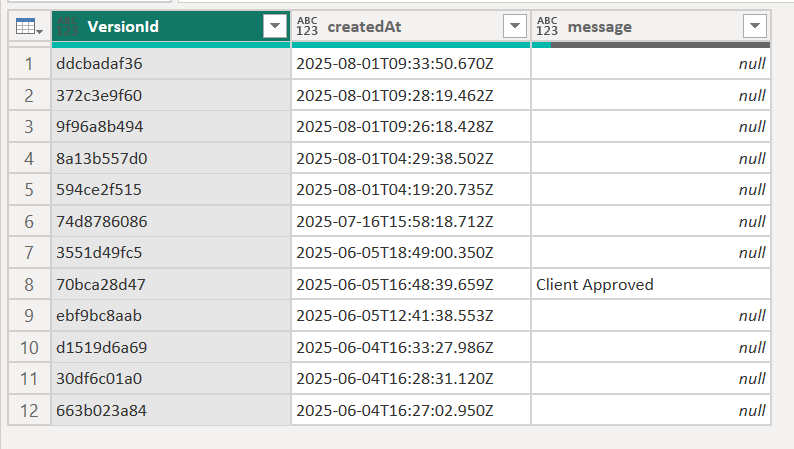

In the meantime, you can make a query that just gets you version dates like this:
let
  response = Speckle.Api.Fetch("https://app.speckle.systems",
    "query($projectId: String!, $modelId: String!) {
      project(id: $projectId) {
        model(id: $modelId) {
          versions(limit: 100) {
            items {
              VersionId: id
              createdAt
              message
    [projectId = "3b81e5731b", modelId = "df67438eb3"]
in
  Table.FromRecords(response[project][model][versions][items])

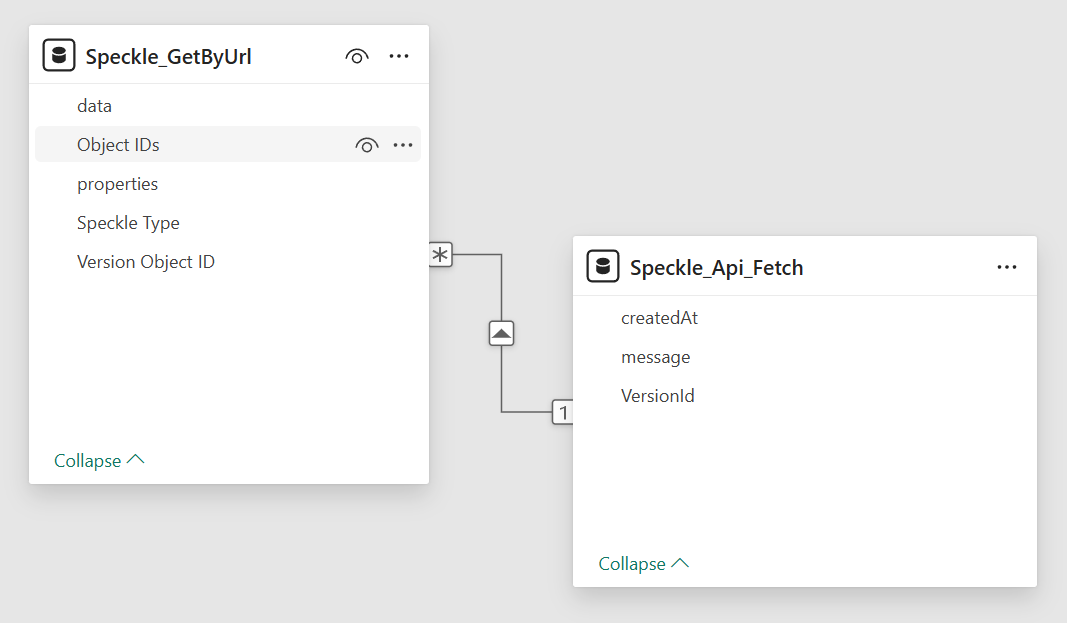

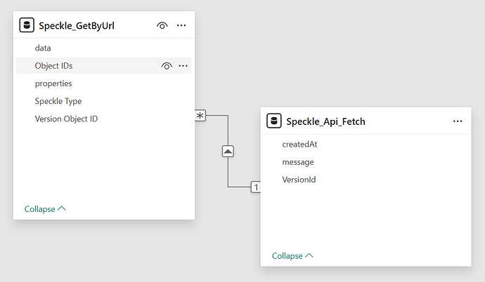

You can then add a many-to-one relation between your normal Speckle Query and this to make the date available to slicers
Alternatively you can perform a table join if you need the version date as a column in the objects table - probably unlikely, but we can show this method as well.
This approach may well be preferable to adding the version date as a column of data by default, simply as less data = quicker dashboards
