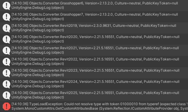

The output is as follows:
As you can see, it seems to search for Objects.Converter.Revit2025 and tries GetCustomAttribute(), fails and throws an error.
The full error here :

However, the odd thing is that it doesn’t occur on all pcs. This will still occur in executable builds, and executable builds will have the same failure for the same PCs but work on the rest. I have been trying to figure this out for quite a bit and have finally narrowed it down to this for now. The usual advice for deleting the obj/library folder doesn’t work, and using different projects, or as detailed above, even a clean project with minimal code will reproduce this error, and will consistently occur on the same PCs, executable builds or otherwise.
My current theory is that it is occuring on PCs that have Revit installed where Revit 2020 does not exist. We do not have that many pcs/license combinations and currently its not feasible to test it out for now.
