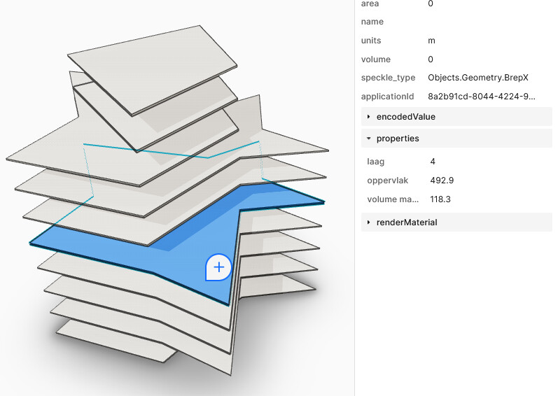

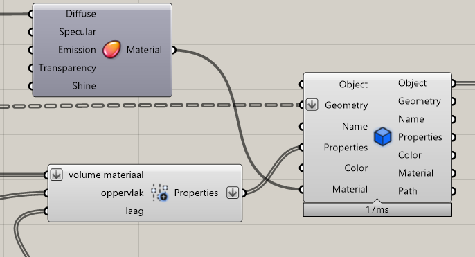

I am making a model in Grasshopper, with objects where properties are attached to.

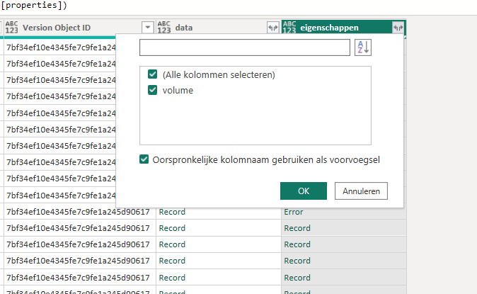

In the viewer they are visible, but in PowerBI I cannot see them anywhere.

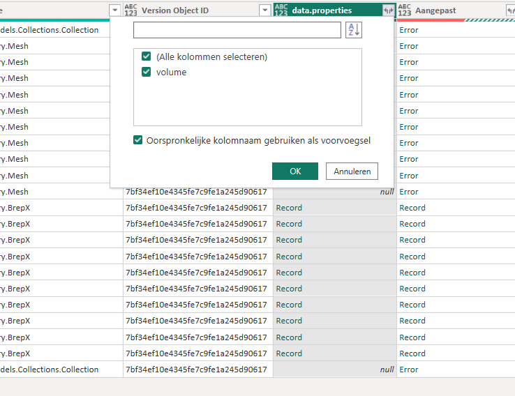

If I look in the column data.properties, they are not visible

well even after reloading the data I get this:
this is from the first version of the model I made. It looks like somewhere there is some cashing done, which is not being overwritten. After closing Powerbi and opening a new PowerBI document, importing the speckle data, I get the new geometry but the old property data.
You can try resetting the cache in Power BI.
Hi @gokermu,
That worked, thank you

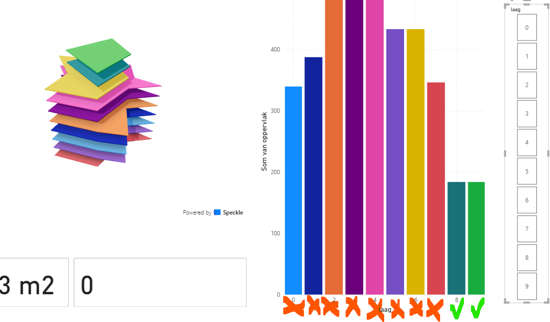

Again some problems.

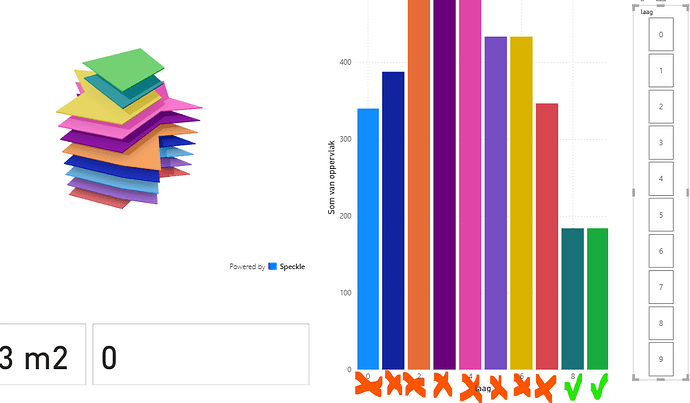

The colours of different graphs do not match as expected.
The colours used are the same, but only the two top levels are matching with the bar chart.
Hey @Erik_Beeren ,
This is a known limitation. There is no OOTB way to override colors. There is a workaround you can use with conditional formatting. Take a look at this video for reference: https://www.youtube.com/watch?v=xsHnz1mc9mw
