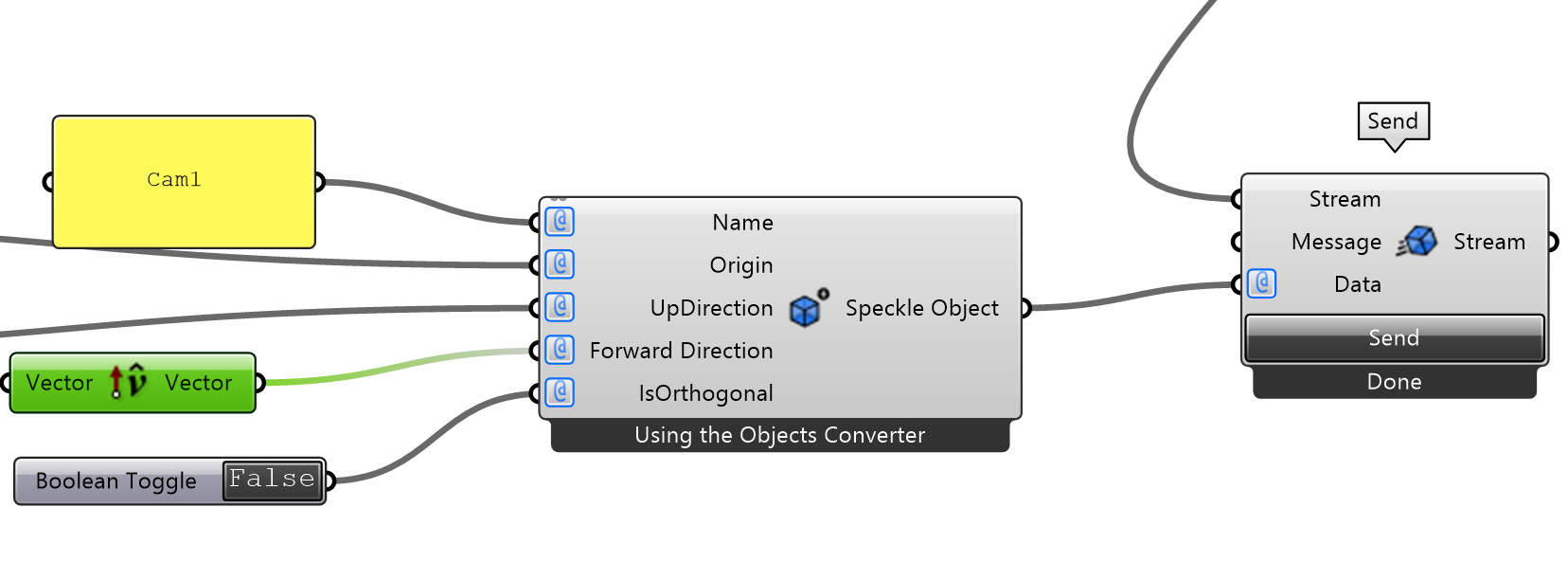

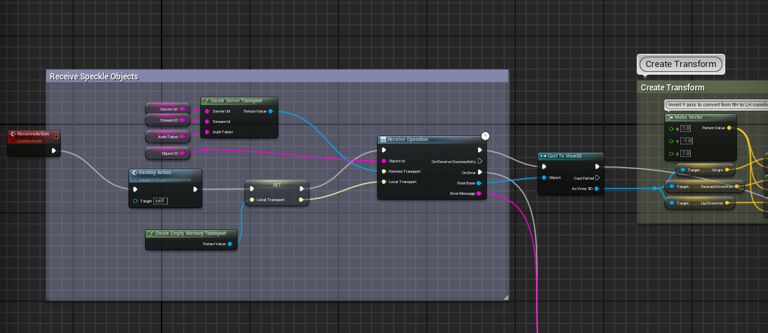

I have tried to simplify the unreal blueprint examples you created into simply checking if the stream has a View3D object and then extracting the transforms to spawn a camera.
There is a custom camera object with the transforms created in grasshopper needed to make a camera in Unreal Engine, however how do I structure the data so that the blueprint script recognizes that is is a View3D type when casting?
Here are screenshots of the custom speckle object i created and the blueprint which i pieced together from the existing examples in the plugin folder. I am just using the blueprintrecieving script to combine all the parts rather than the speckle manager and converter as i got a bit lost following that method.
