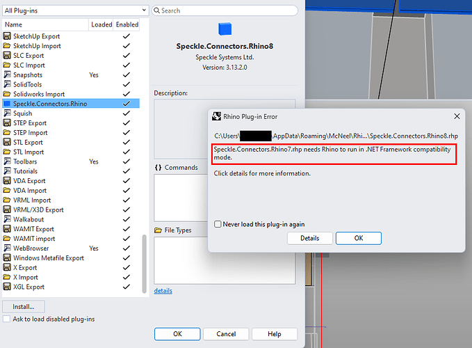

Getting this error when manually loading the plugin:
Had to delete the Rhino 7 V2 Plugin that was persistent after an uninstall. Once deleted V3 works on Rhino 8.25. Thank you!
