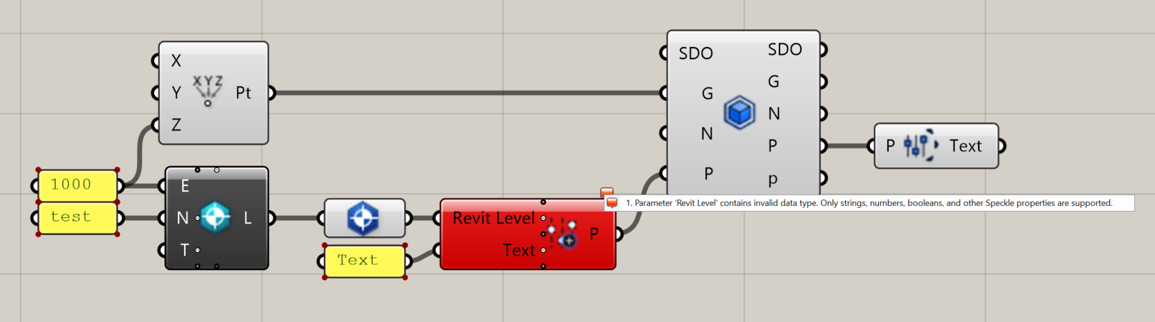

Hi, I’m trying to use Speckle Data Objects in combination with RhinoInsideRevit.
I was hoping that I could use Revit params and properties as Speckle properties, but it seems that this is not (yet?) the case. See screengrab below.
In a previous Speckle version there were multiple Revit properties that I was able to send through Speckle. Now if I were to convert a Grasshopper model to a Revit model, what would be the best way to go about this?
Hey @HaskoningBram ,
Our nodes are not Revit aware. So giving Revit elements raw won’t work. But you can get the parameter names and values and send those instead.
