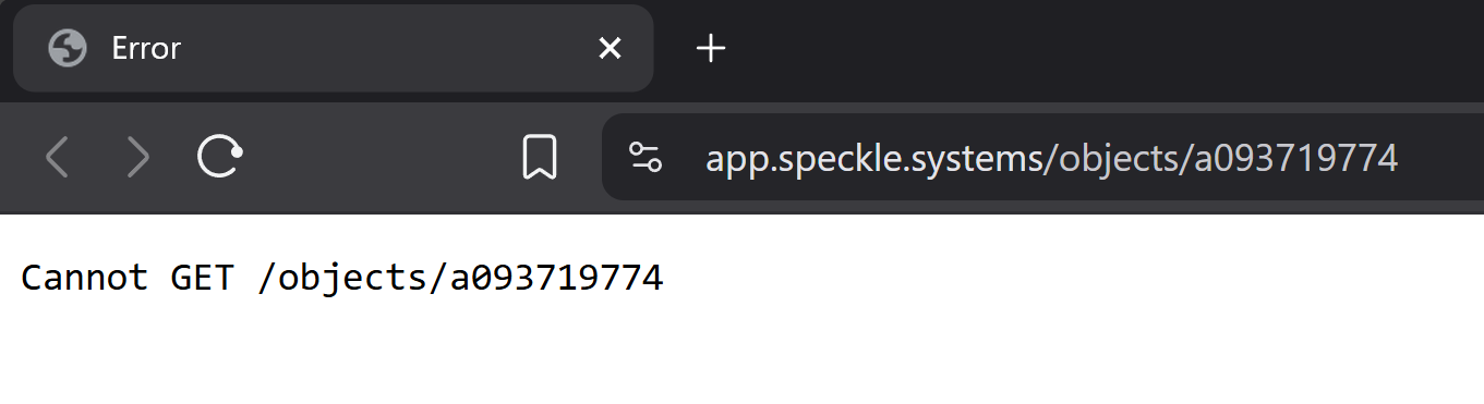

I got a bad request:

Hey @iltabe
There was an issue in objectsender, that made the sent objects unloadable in the viewer.
We’ve fixed that and version 2.25.1 is running through the release process right now, should land on npm soon.
Thank you @gergo !
I was able to send again after updating to 2.25.1
