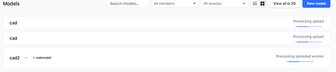

I have tried to upload various CAD files to a model, both DWG and DXF and so far I have not found a single one that will work and I wonder if you could provide a working example so I can test this feature?

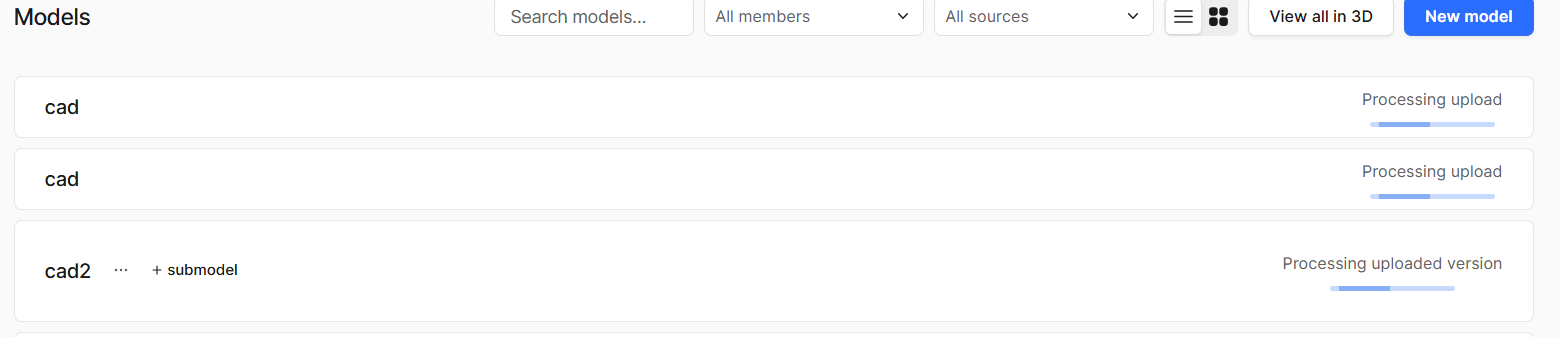

It is still processing upload after 30 minutes. The DWG opens without warnings in TrueView and is quite small.

That did not help and I can not delete the old one.
