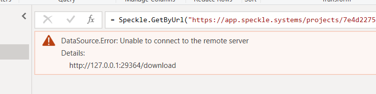

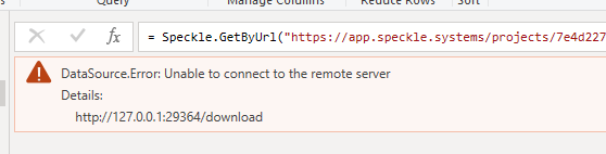

Hi again! Halfway through the day I started getting this error again, although it was working earlier.
DataSource.Error: Unable to connect to the remote server
Details:
http://127.0.0.1:29364/download
Is something changing?
Should I wait and hopefully it will get solved?
@gergo any changes in the server side?
Hi @Anastasia,
Somehow the service we used is not responding on your end for a reason. It is hard to say without seeing it. I am happy to jump in a call to understand it better.
hi @oguzhan ,
Just downloaded the latest connector for power BI (3.0.0-beta.76) that came out about an hour ago and it seems the issue is solved.
I’ll let you know if the issue appears again!
It is still suspicious that your service stopped working for a reason. Once you installed new version it triggered the service again and thats why it is solved I guess. If it happens again, let us know please.
