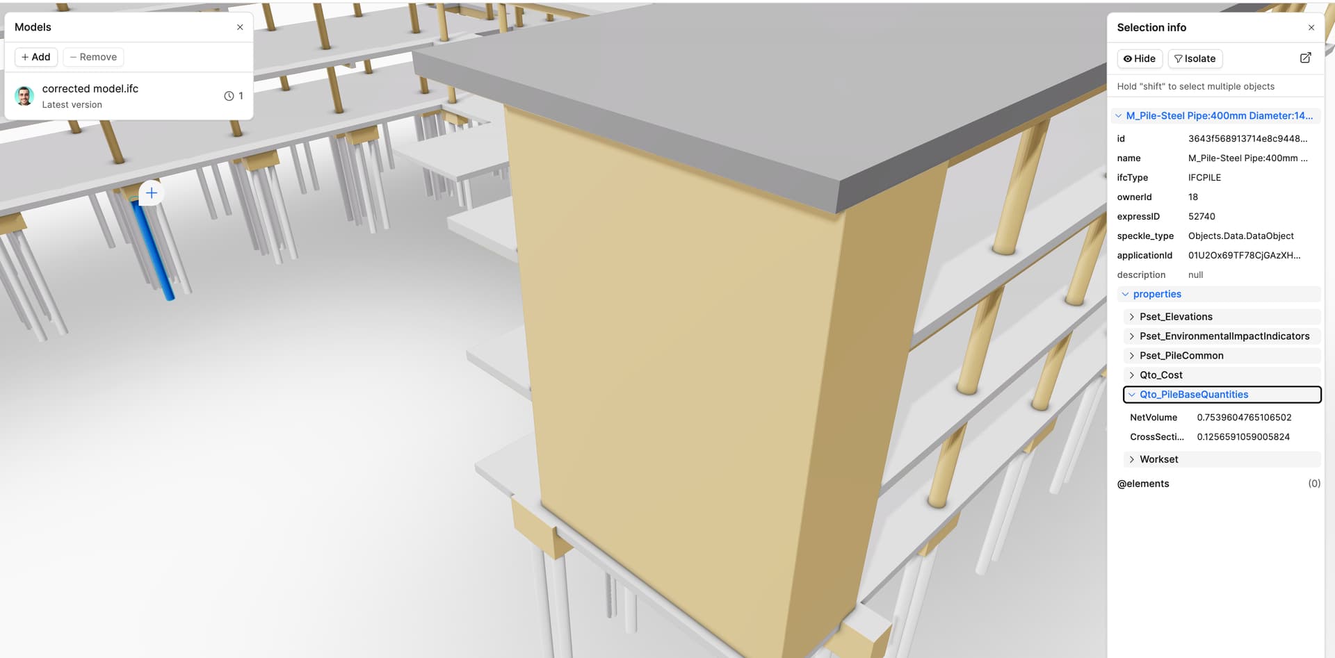

I have a question regarding Speckle,I recently tried out Speckle and noticed that when I uploaded an IFC file and examined its data in Speckle, everything was there except for quantity sets.
Can you tell me what I am doing wrong?
Streamlink :Viewer - Quantity Comparison Based on modelling - Speckle

Can you please share the source IFC files too? So we can compare the data available in Speckle with the original IFC file.
Hey @Shobhit_Suthar ,
This has been fixed in the 3.1.0 version of our Revit connector.
