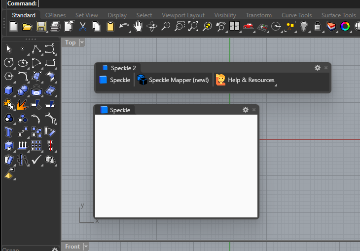

Having a weird problem where the speckle UI just doesn’t appear in Rhino 8.
Any hints or tips welcome! Everything is up-to-date as far as I can tell.

Hi James, we’re aware of this - unforch it’s a rhino bug on panels (or looks like one).
The fix: dock the panel somewhere cozy, close rhino to save its location, open rhino, profit!
PS: I’m assuming you’re using our server. If it’s yours, the issue might be different (you might need to update it).
So I couldn’t get the trick to work, got annoyed, reinstalled Rhino and now everything works again.
Having read the post, I do suspect that Rhino bug has something to do with it!
Both before and now I have both your server and ours connected in the speckle manager. So i guess it could have been something with our server but not sure.
