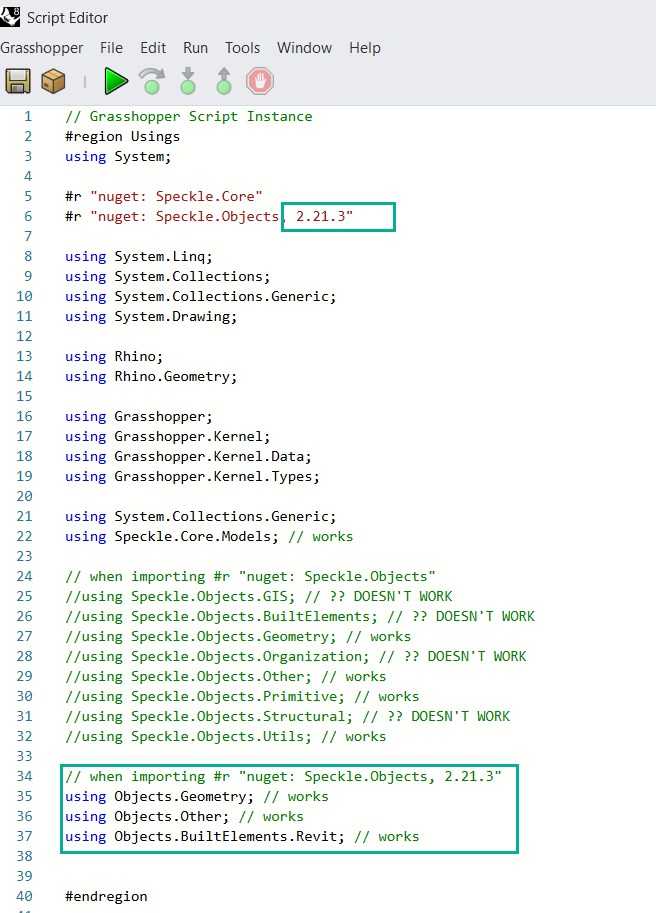

I was struggling to access the Speckle.Objects namespaces in the Grasshopper C# component. Specifically the BuiltElements namespace. I solved it, but am sharing here for others.

import the specific nuget package version you expect (in my case 2.21.3)

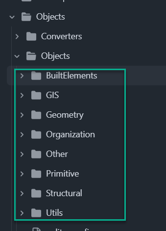

I want to access all of these namespaces, as shown on the speckle-sharp github

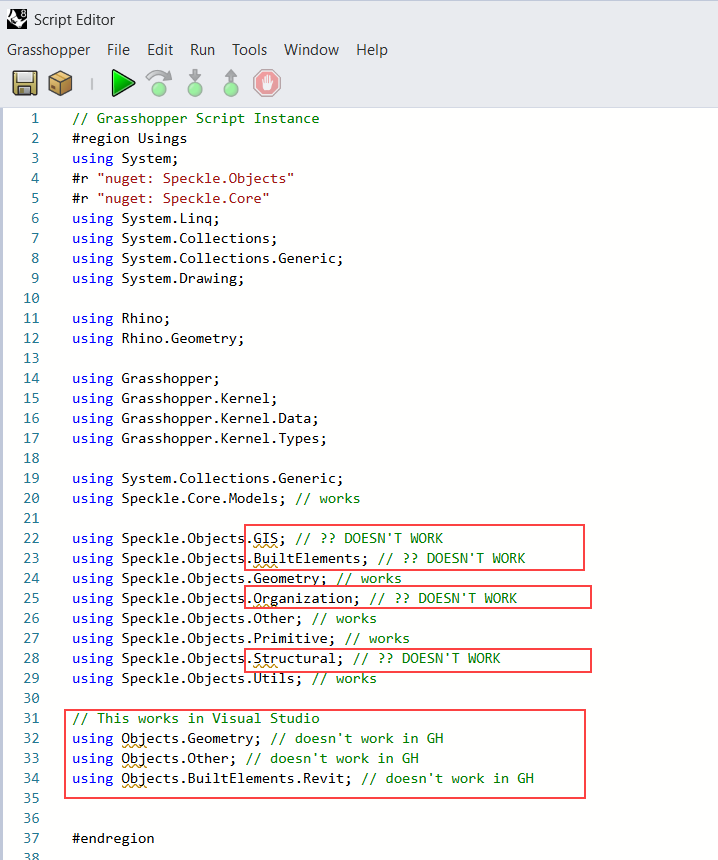

I am able to import both Speckle.Core and Speckle.Object nuget packages but the using statements confused me.

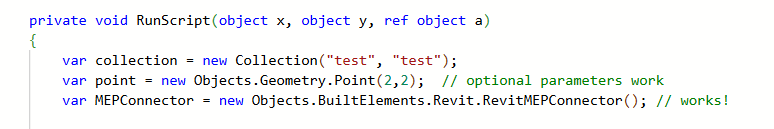

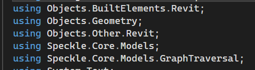

In my ASP.NET application (which used 2.21.3), my using statements look like this:
But in Grasshopper, rather than Objects.NameSpace I need write Speckle.Objects.NameSpace. This doesn’t match the Speckle\Objects\Objects... structure shown on github.
What is really odd is that some of the child namespaces work, but not all:
As you can see below, I am able to use those namespaces that import.

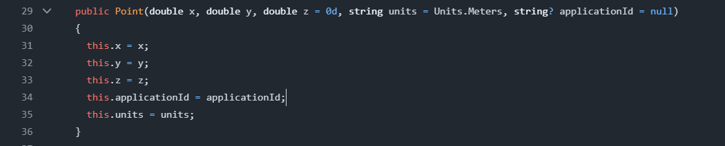

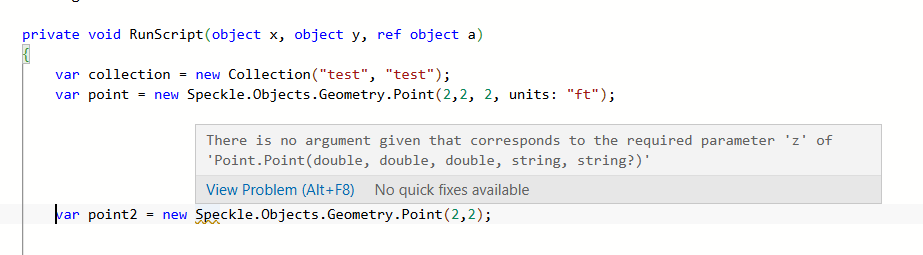

The clue that tipped me off to the package issue: I had to include the z and units when creating a point, but on github these are listed as optional. Perhaps I am using an older version of the nuget package?

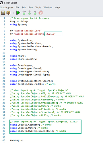

Once I specified the specific package version I expected, the using statements worked as expected and I could access all namespaces.

Are you sure you’re using 2.21.3 in grasshopper? I suspect you’re actually using some 3.x version (which, won’t be compatible with Speckle.Core)
The namespaces you’re showing (e.g. Objects.Structural, Objects.GIS, etc..) only exist in the 2.x.x versions of Speckle.Objects, where all objects are namespaced Objects.
In the 3.x.x versions of Speckle.Objects, all object models are namespaced under Speckle.Objects., and many of the namespaces you’re showing no longer exist since we’ve switched to a DataObject based design.

You should either use 2.21 everywhere, and reference everything via using Objects. namespaces etc…, and enjoy all of the v2 object models.

Thanks Jedd. Yes, seems my confusion was that I was familiar with v2, but was importing v3.
As you point out, I should also be importing the specific version of Speckle.Core that I want to ensure it is v2, not v3.
