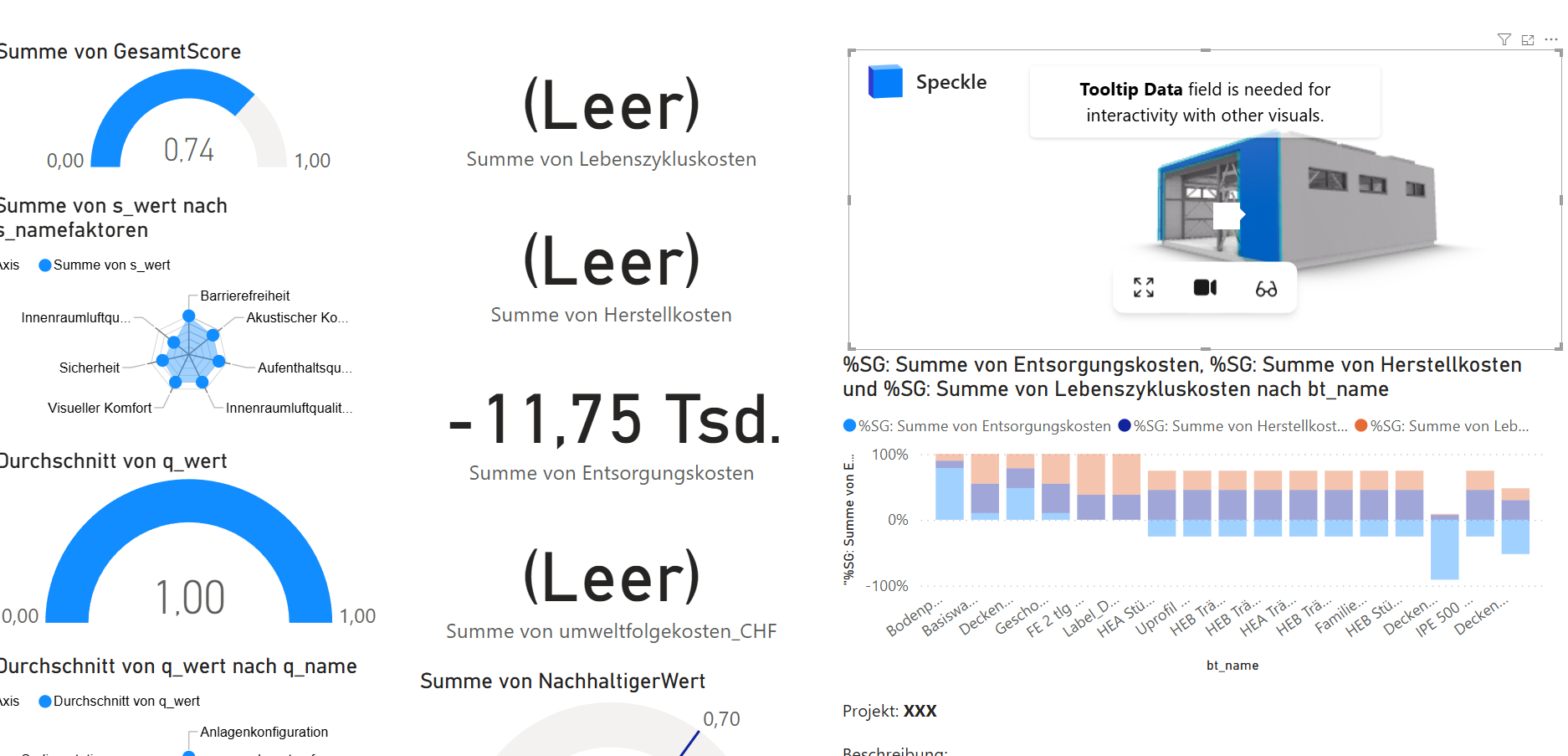

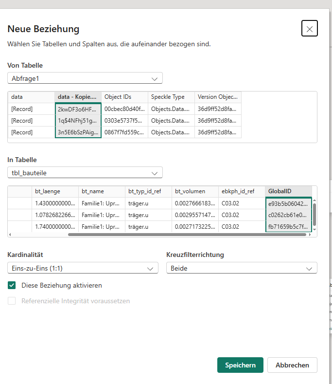

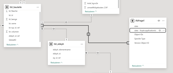

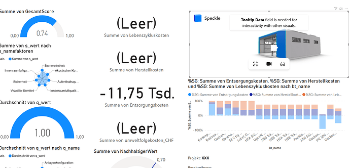

while I was installing the latest Power BI Connector, I cannot get the tooltip from a linked table. Even though I make sure there is a 1:1 relationship possible by linking the GlobalId with the ApplicationId. It worked in the older Speckle viewer anyway. Maybe I have done something wrong. I hope you could help me out, even tough I have one month left to hand over my these :smiley:
speckleconnector Version:
Kind regards Hakan

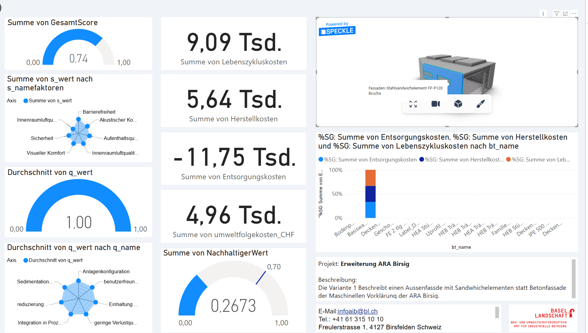

old Speckle Power BI connector
new Speckle Power BI conector which dont show me the tool tipdata or is interacting with other data

Selam Hakan,
You are right. Thanks for sharing this issue in such detail. I’ve added this to our backlog. We’ll have a sprint soon on Power BI 3D visual. I will ensure we include a fix for this as well.
