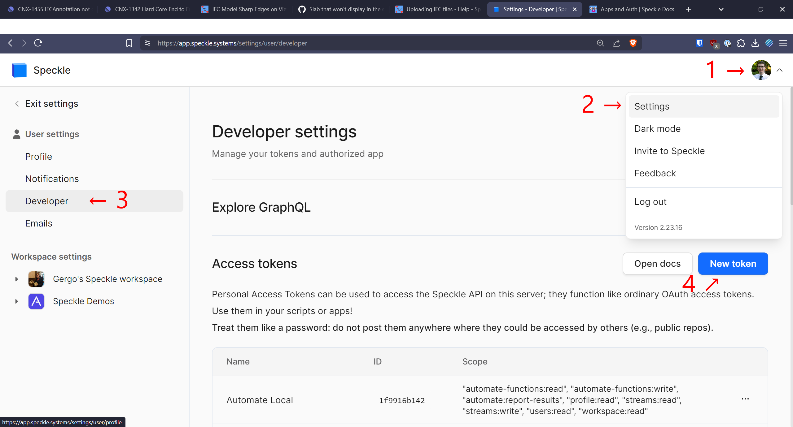

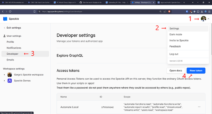

You can generate an access token AKA authentication token from https://app.speckle.systems
If you click on your avatar in the top right, and open Settings than under the Developer tab, you should be able to create a new Access Token.
When setting up a token, you’ll be prompted to add scopes. For Unreal, you should add streams:read and profile:read
Please see these docs for the complete “getting started” instructions.

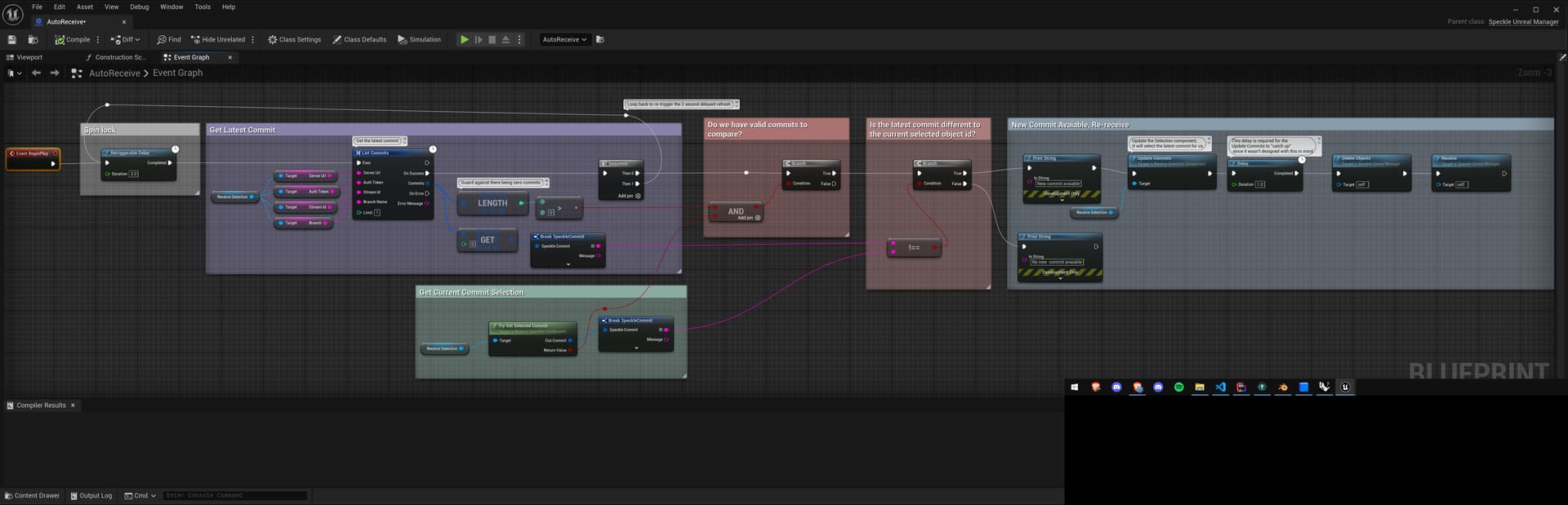

I have a BP that I demoed to another user last year, I’ll share it here incase its useful for you.
In short, we setup a timer to poll every couple seconds if there was a new commit made to a specific branch.
here’s the link to the Unreal blueprint Speckle Auto Receive Demo posted by anonymous | blueprintUE | PasteBin For Unreal Engine
To get this setup in your own project, it should be as simple as:
  • Opening the content browser
  • right clicking, creating a new blueprint class, with SpeckleUnrealManager as the parent
  • Opening the blueprint, and in the EventGraph, pasting in the linked blueprint.
    In case the link doesn’t work, here’s a high resolution screenshot to recreate manually.

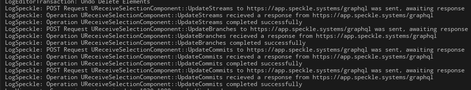

I’ve attached screenshots perhaps you can figure it out. No models are imported even though I see the commit “pushed 5 elements from Grasshopper” as shown in the screenshot.

I would expect the blueprint to print either “No commit available” and “No new commit available”. Because you’re not seeing that, I can only guess its because the script isn’t running.
The blueprint I shared is setup to run on Event BeginPlay i.e. running the level via the green :play_button: button (Play in editor) or a built application.
I would give this a go, hopefully it should then work.
If you want the BP to run while in the editor instead, you’ll need to adjust it.
