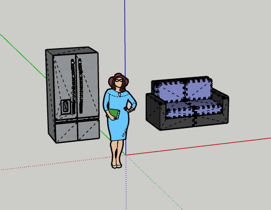

I have a little issue with the Speckle viewer
  • Objective: Uploading a model from Sketchup 2024 to Speckle with Sketch up Connector 3.0.1 and viewing it with @speckle/viewer": “2.18.16” in our web app.

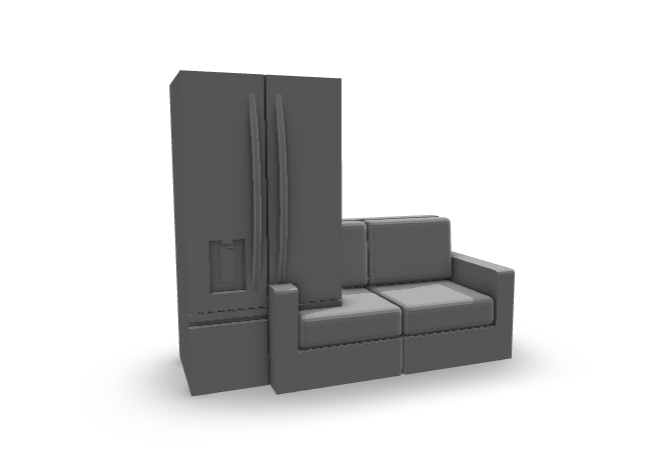

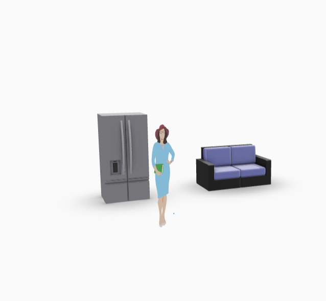

  • Issue: The model looks fine I upload it to speckle, with the Sketchup Connector 3.0.1, I open it in Speckle the model still looks fine, I copy the model id in our web app where we use the @speckle/viewer": “2.18.16” and all objects jump to the origin, individually

    Sketchup:
    Speckle Web:
    @Speckle/viewer": “2.18.16”:

Ps: Please help me get the lady out of the fridge, she must be freezing :frowning:
Hi @bobo0025,
New connectors has different approach to handle components (instancing) which we call them proxies. @alex implemented a way to handle them at some point. My guess is that you might be living in quite old viewer version without proxy support. I believe thats way the lady is freezing :cold_face:
Hi @bobo0025
@oguzhan is right about this. The first thing you should do is update to the latest viewer version. In case you worry about breaking changes, we also have a migration guide which you can check
