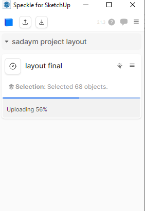

Hello every one, i have a small issue, which is when i try to publish a sketchup model (which i have previously published before, iam republishing because i did some minor changes to the model) speckle keeps reading that its uploading but keeps getting stuck at 56% upload forever.

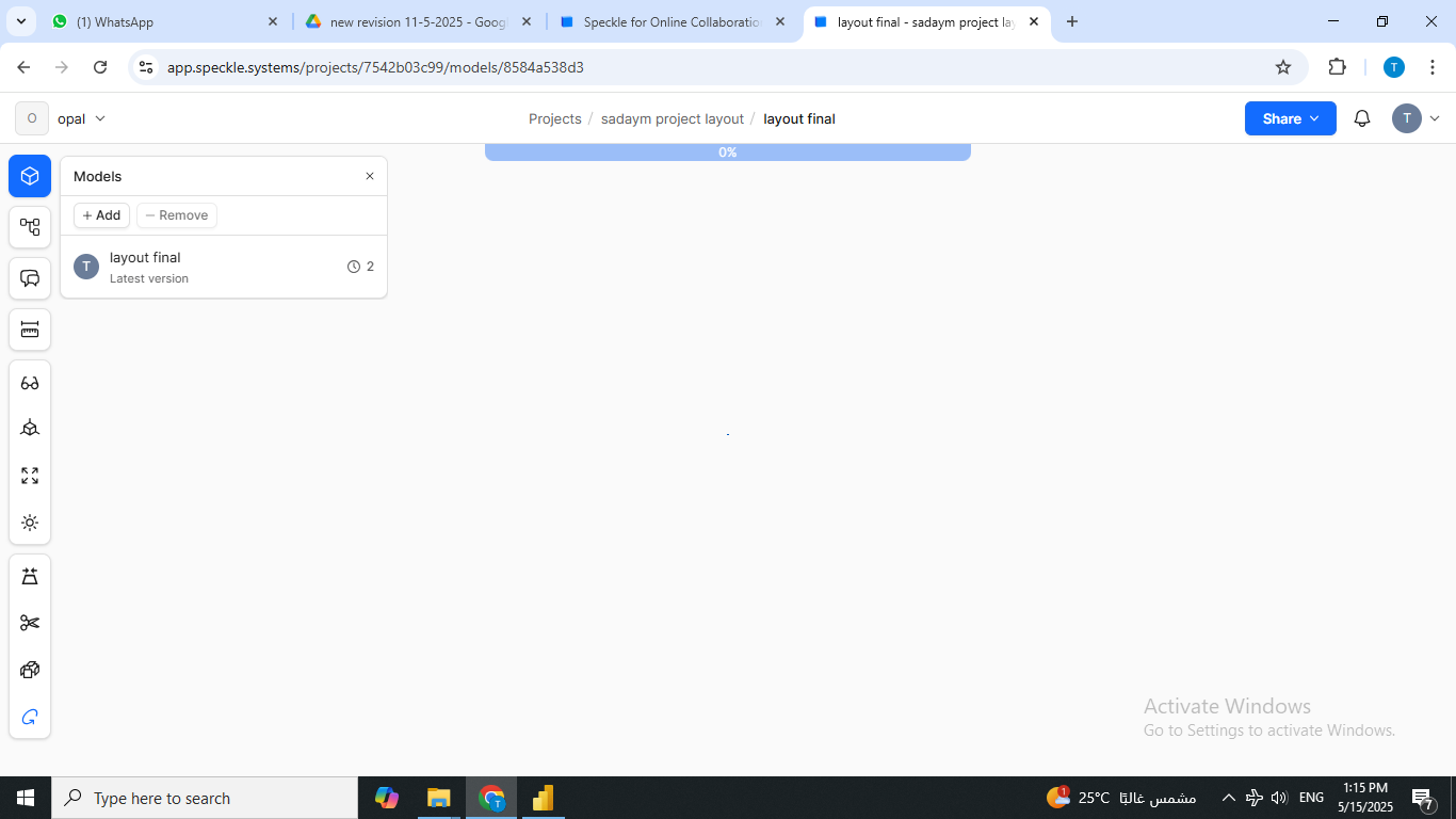

thank you, it seems a certain component was getting in the way but now i have a different issue sadly, after the model was published i went to the online viewer and it is there but it never loads, its stuck forever at 0%

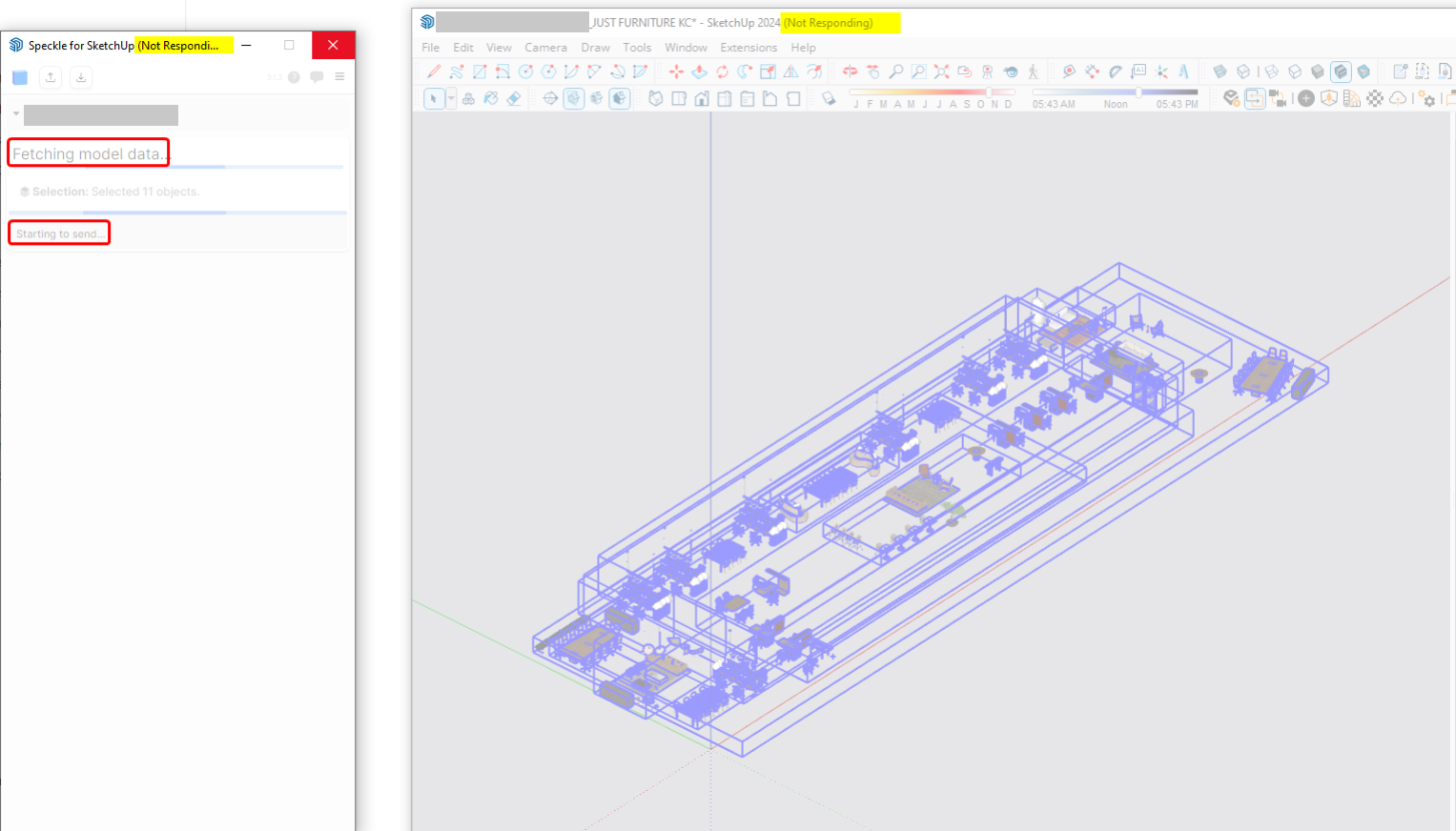

I’ve run into similar issues with certain SketchUp files.
Is there a way we can get more info when Speckle “chokes” on a particular component or group (if that’s what’s happening).
Instead of it hanging in the “Uploading” or “Fetching model data…” mode in the connector window?
Like an additional error window that says we should remove a particular element for Speckle to work correctly.
