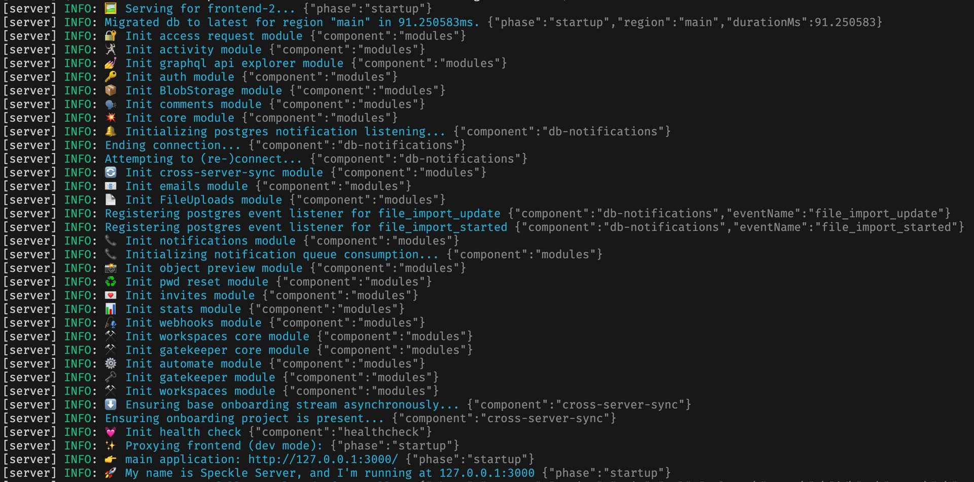

This will run the server component in isolation. Does the server start up properly? The server log should look like the following if successful:
