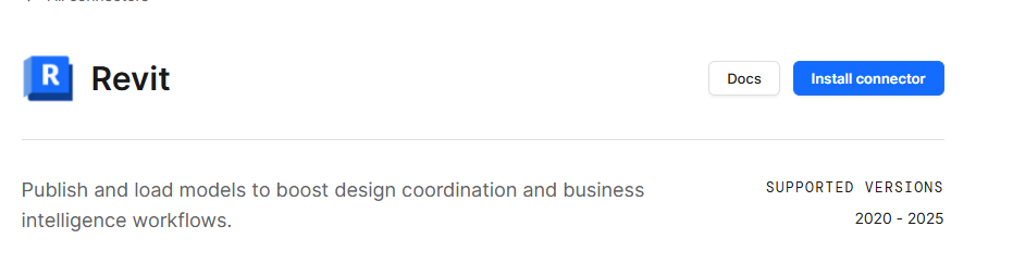

Hello, I think the connector doesn’t work yet for revit 2026. On the download site it says only 2020–2025 are supported.
