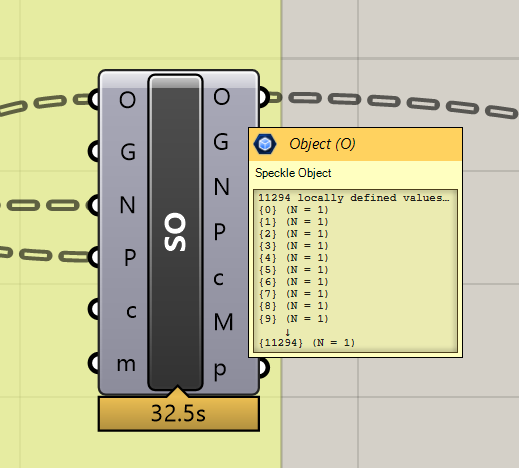

Hi, I am using the new speckle connector for Rhino/Grasshopper (v 3.3.0) and in one use case I have created more than 11000 objects in less than a minute. See image below. In this case, the objects are Breps (simple extrusions) and 23 properties per object.

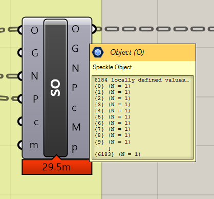

In another similar use case, I am trying to create ca. 6000 objects with very similar characteristics (Breps as extrusions and 17 properties per object) but in this second use case it is taking 30 minutes, which theoretically should be faster. See image below.
Can you please explain what is happening behind this component or what is the criteria to make it run faster?

Hi @clrkng, in both cases, I am creating new objects passing the Brep geometries (simple extrusions). The properties are text, integers and decimal numbers.
The weird thing is that both cases are very very similar. Even the geometries are more complex in the fast use case.
