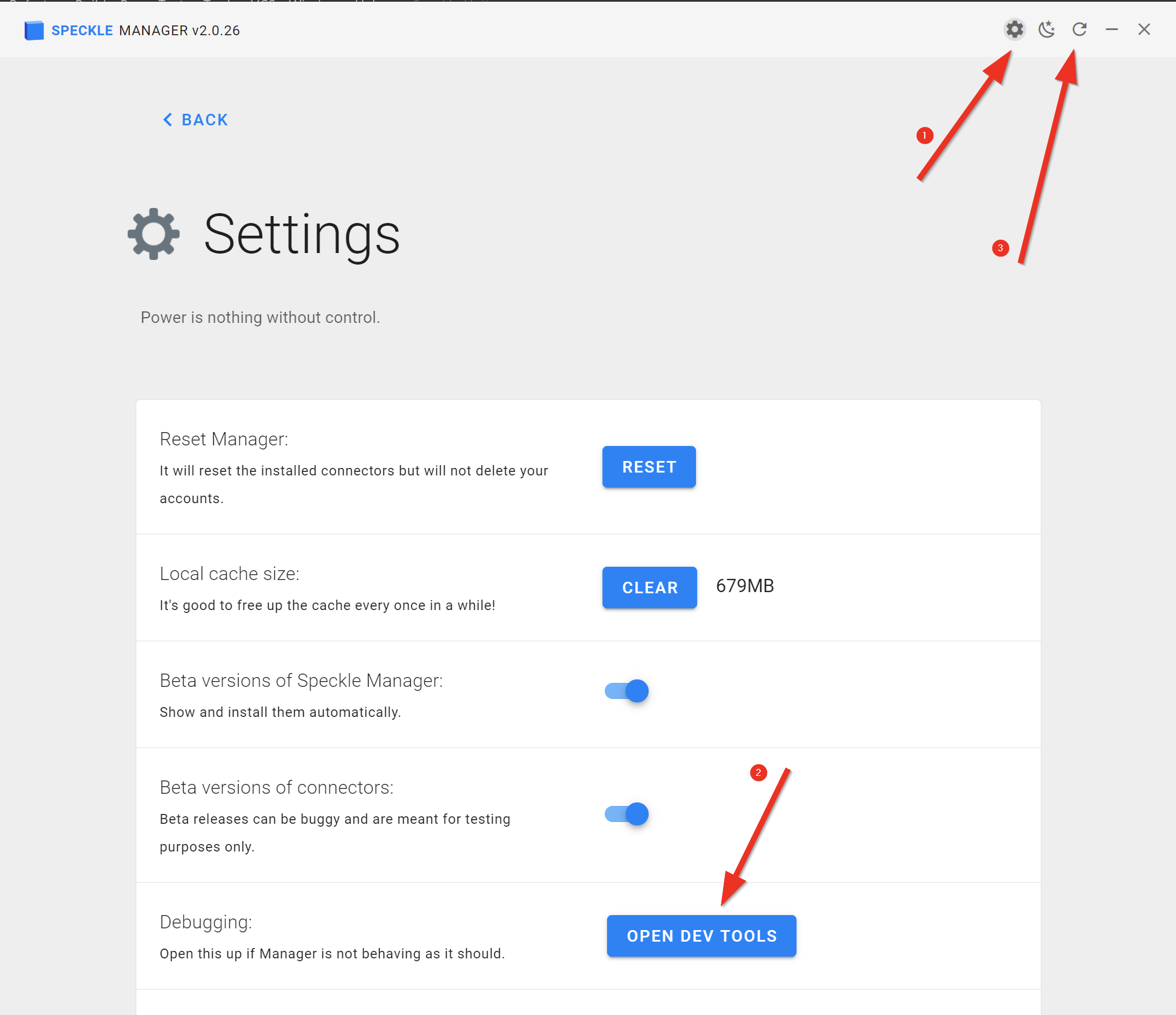

Could you please:
  1. open the settings page
  2. open the dev tools
  3. click refresh
  4. report any error messages you might see there
