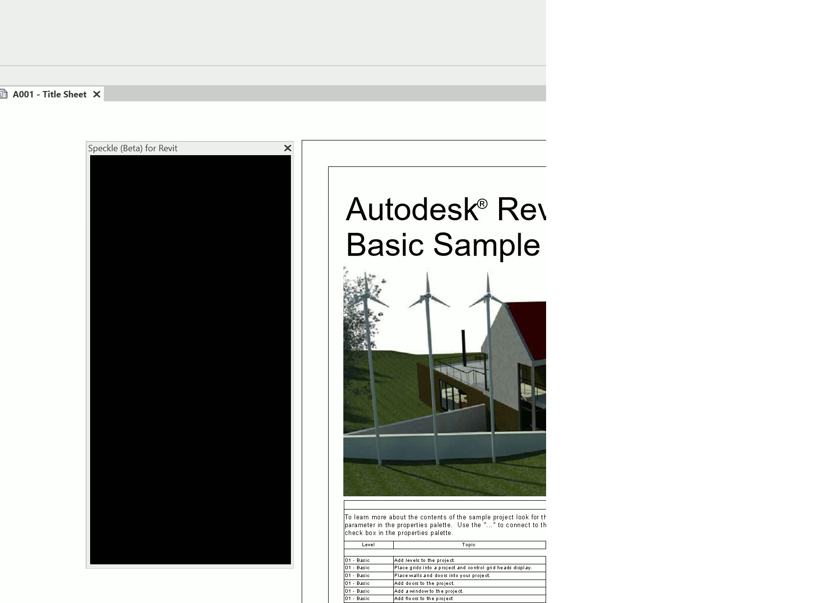

I can log into the service, register
but in Revit, for example, I see a black window from the connector without the ability to connect to a custom server
ok, I think

doesn’t work..it doesn’t try to connect to the home server, black connector window
