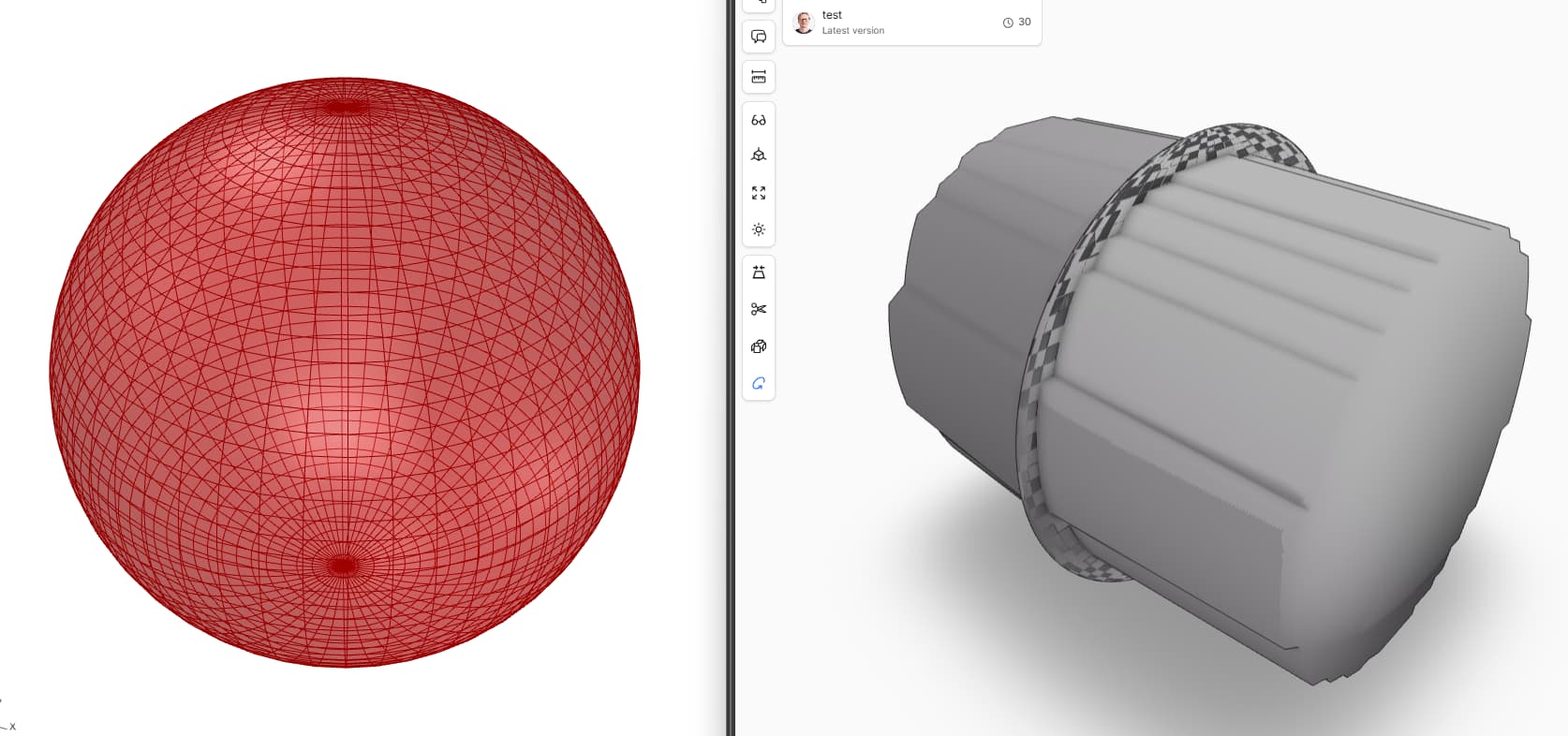

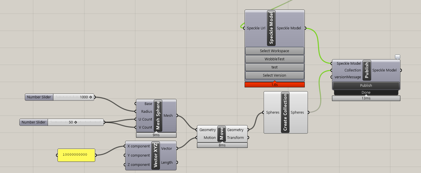

On 3.6.3 this fails on a very simple test case:
test.gh (11.4 KB)

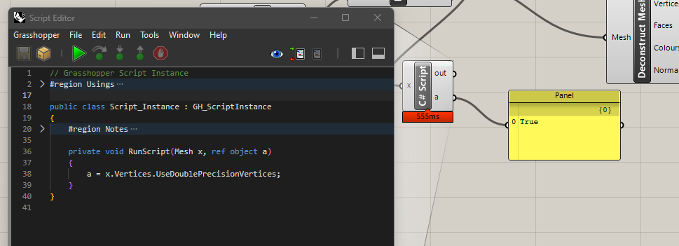

Looking at the Grasshopper implementation of the Speckle plugin, I think there might be some incorrect assumptions - Grasshopper does, in fact, use double precision meshes - you can check the flag UseDoublePrecisionVertices:

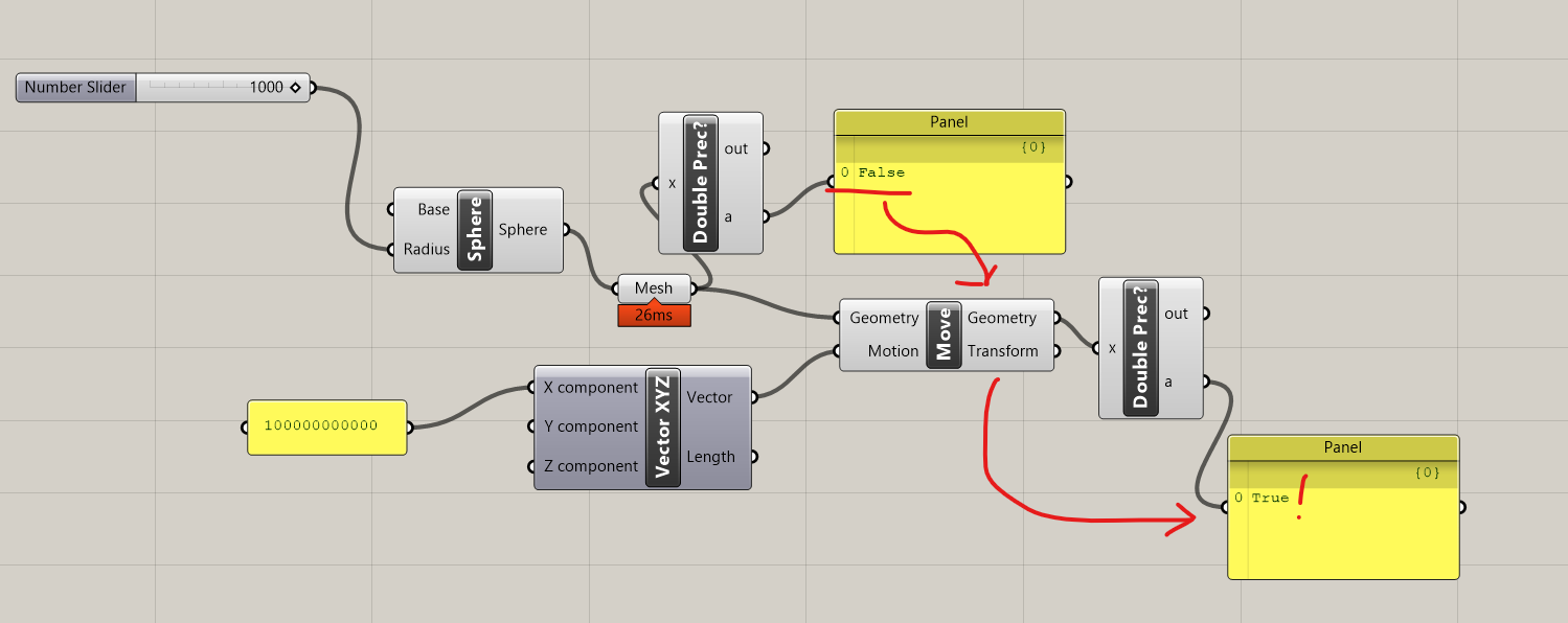

In some cases, like with Brep conversions close to zero, a mesh will be created without double precision enabled, but when you transform it to the point it needs it, it will become enabled:
To get the double precision points from your display meshes, you should just be able to go mesh.Vertices.ToPoint3dArray() and use those values.
