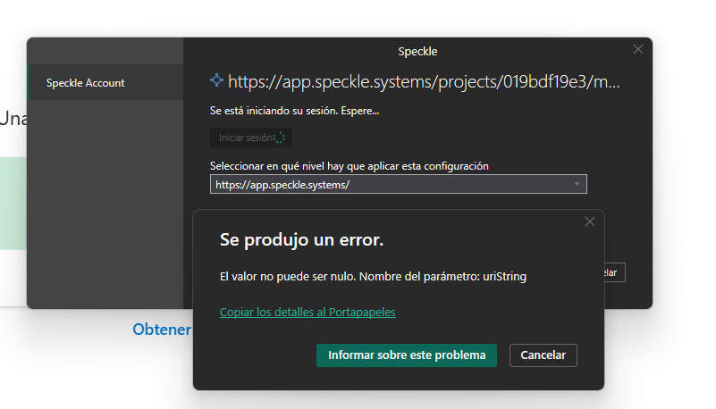

Speckle error message when trying to sign in on PowerBI
Hi everyone, I came across an error message when I try to sign in speckle in PowerBI. Please help…
  • Objective: Sign in to speckle on PowerBI
  • Issue: I receive an error message when I click on ‘sign in’ in Power BI Desktop.
  • Example: Error says Value cannot be null. Parameter name: uriString
  • Speckle link: Any speckle link I use gives me this error.
    for example: Viewer - LEO's First Project - Speckle

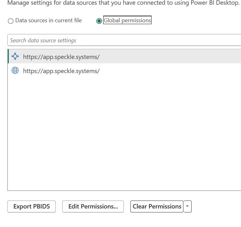

File > Options and settings
Data source settings
Global permissions > Clear Permissions
Sign in
See if that helps - the dialogs will be in your language, but should be similar.

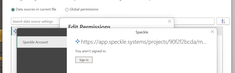

the problem continues…

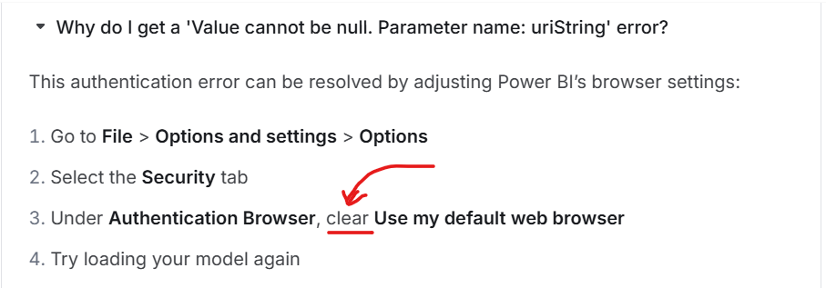

Please check the documentation: How to use Speckle for Power BI - Speckle Docs
Thanks! The problem has been solved.
