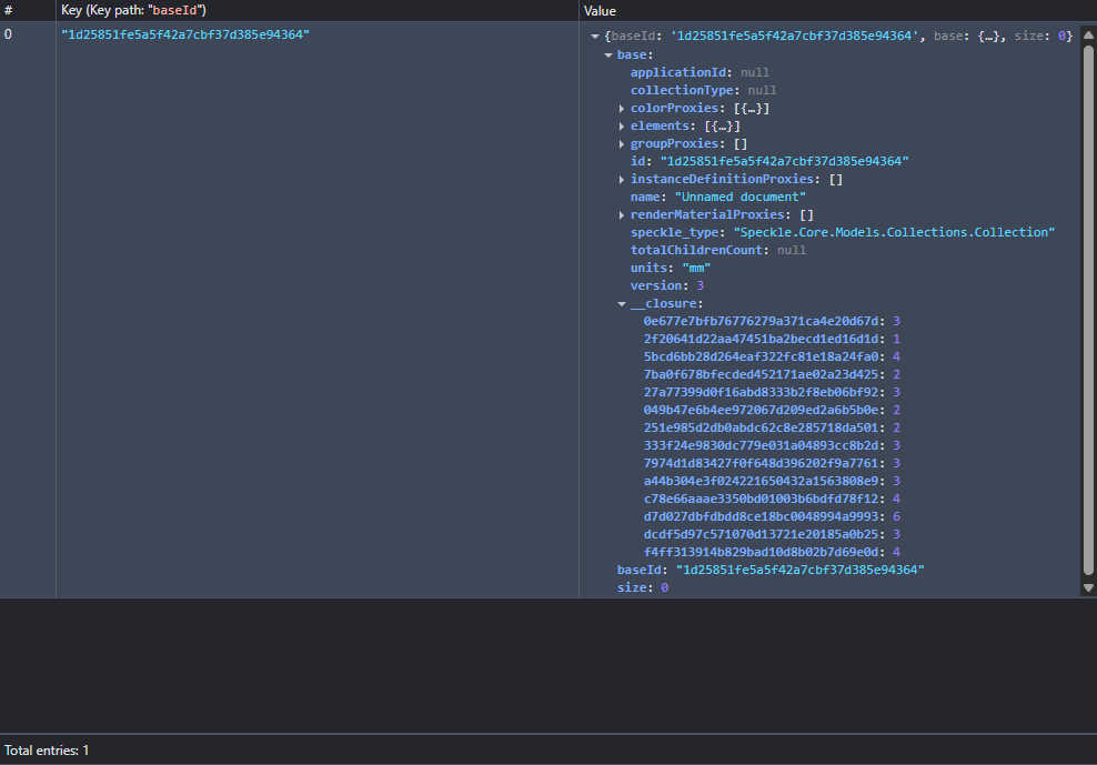

Hey @adamhathcock !
I think I understand what you are saying, however when I clear the whole cache it will check and cache the root data only, hence the screenshot i provided is after I clear the cache, only root data is added but not the rest. Is this intended? Because I thought if the whole cache is empty it will cache the root and other data too.

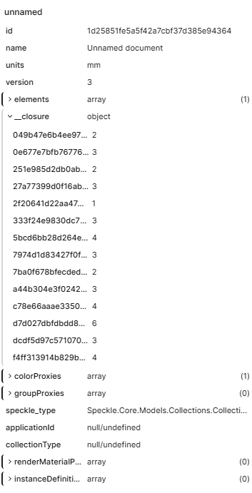

oh maybe I have some misunderstanding on what a base object is, but isn’t every speckle object considered a base object? That includes detached properties like faces and vertices, essentially every reference id in the root node closure is a base object, and if that’s the case then it should have more than just 1 base object right?
Here is my project link
attaching my response for project/object query

Please correct me if I misunderstood any parts, and again grateful for your help :saluting_face:

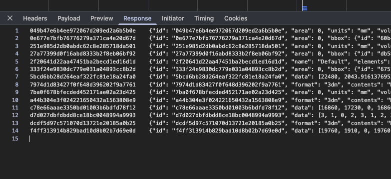

You’re 100% right there that they all should be in IDB. In my test environment, I get everything there but not in the prod environment.
I’m not sure why they’re not cached in IDB (other than browser settings) but they’re definitely gathered as the call to object-stream/ shows as well as there are no JS console errors

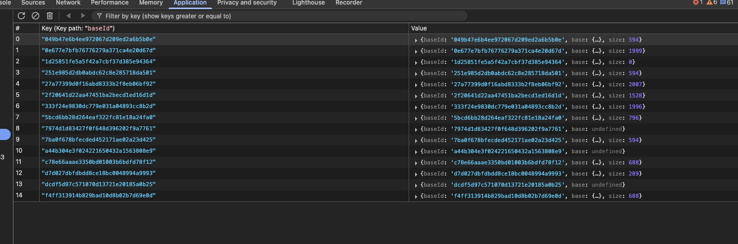

Here’s a SS from my test:
Actually, what I think it being shown here is a situation where I’m not finishing the flushing to the CacheWriter as that behavior recently changed.
Normally, it should write everything when disposed correctly. However, the browser may not finish writing everything when dispose happens and the queue just ends instead of flushing out all the values.
