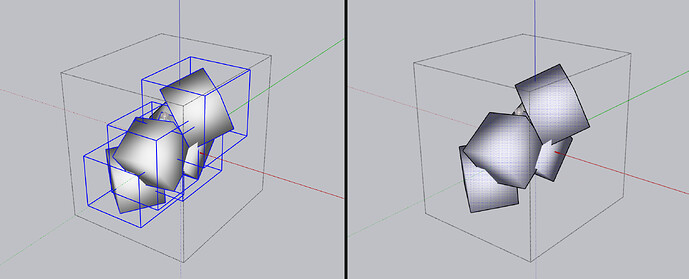

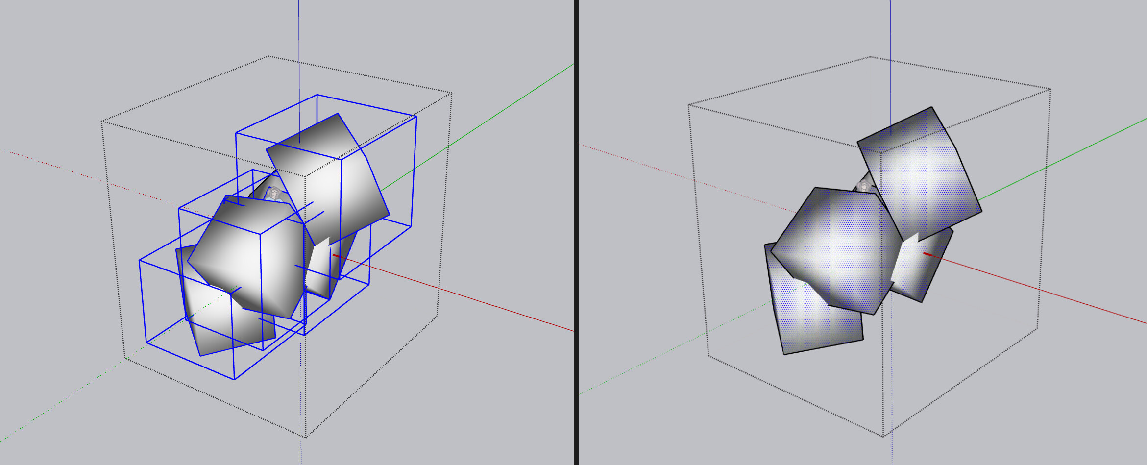

Here are the links to the models created using versions 2.21.1 of the Speckle plugin on Blender4.3.2: https://speckle.xyz/projects/7b94049c5e/models/91f2594016
Using Sketchup2024 receiving the model
