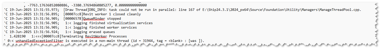

Here’s an excerpt from the latest journal file:
Thank you for the screenshot of the logs.
We’ve shared a Google Drive folder with you in April at the time of your first report, as we currently don’t have any models that reproduce this error—and to date, you’re the only user reporting it.
If you’re able to share the full log file (as text file) along with a model that triggers this issue, we’ll be able to investigate further. As it stands, this remains in a “Can’t Reproduce” state on our side.
Sorry, to clarify I just dropped the 2024 revit model, speckle link, and journal file in the shared google folder.
Thankyou - I have re-opened the investigation ticket.
