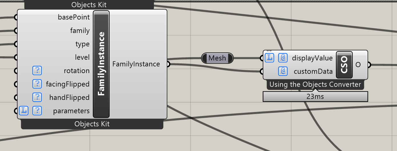

Hi speckle community. Please is it possible to set the displayValue for one of the Revit specific speckle objects in gh? I am trying to view a family instance in the speckle viewer but it only shows it’s a point. When i try to create a new speckle object with the displayValue set to the mesh and a custom data containing the familyinstance object, it shows up in the viewer. However when i try to receive it in Revit, it brings in the display mesh not the family instance.

I’m afraid the way these components have been designed does not allow for that, but you could probably modify the original FamilyInstance object via C# and add the displayValue prop that way: Grasshopper | Speckle Docs

Thanks @teocomi. I did what you said and went the c# route. works great!
