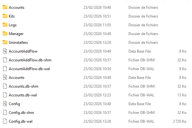

You can find the log files in your directory at AppData\Roaming\Speckle\Logs .
this iswhat i found :
and this :
Please share the files in the Logs/Revit2025 folder.
i am sorry i can not understand how to find it :folded_hands:
Do you see a Revit2025 folder in the Logs folder?
(i have Revit 2026 installed so i have a Revit 2026 folder in my Logs folder)

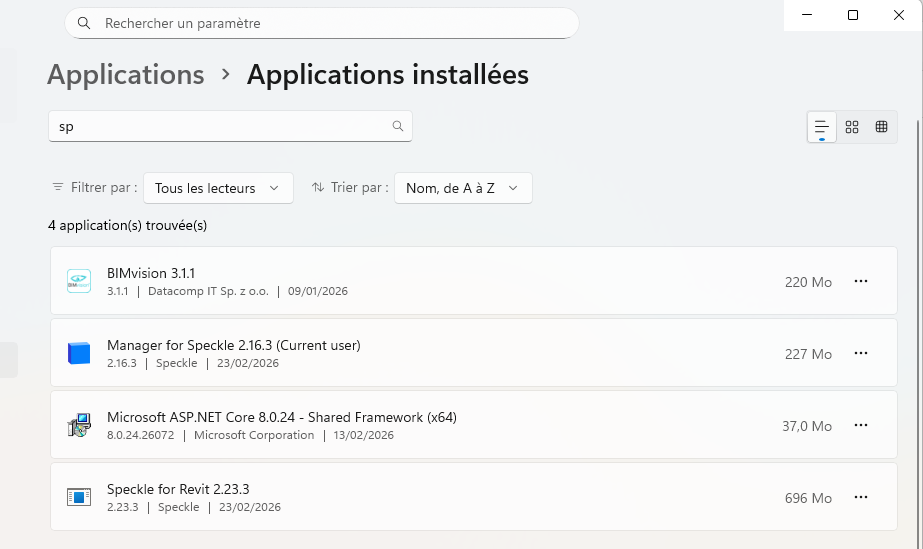

  1. Which version of Revit connector do you have installed? You can see it from Settings > Apps > Installed Apps and search for Speckle.

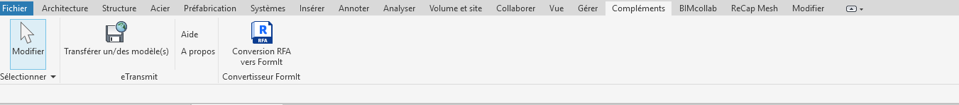

  2. Can you please share the list of plugins you have installed?
For Installed Apps :
For Plugins :
We don’t maintain v2.x anymore. You need to download the latest connectors from app.speckle.systems/connectors and try again.
