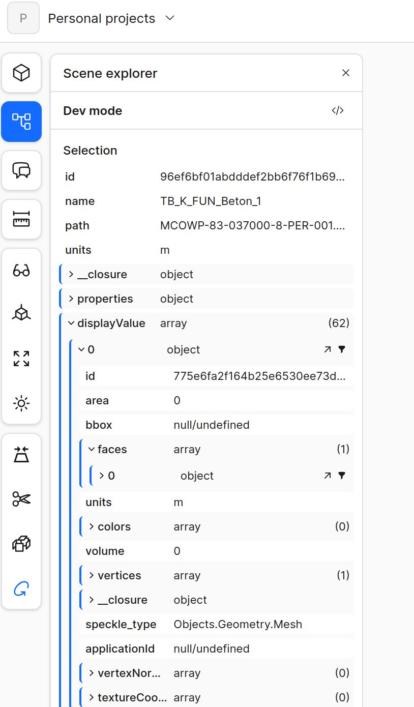

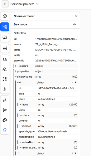

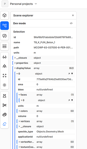

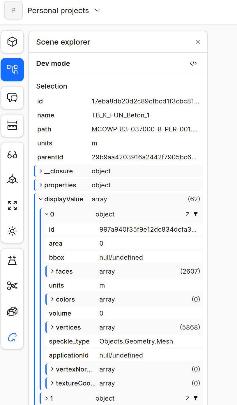

BUT I can see that the objects between the two versions are not the same.
New version:
Old version:
I’m guessing it has something to do with detach and/or chunks?
But that information seems to be lost, when I fetch the data through the @speckle/objectloader or I can’t find it.
