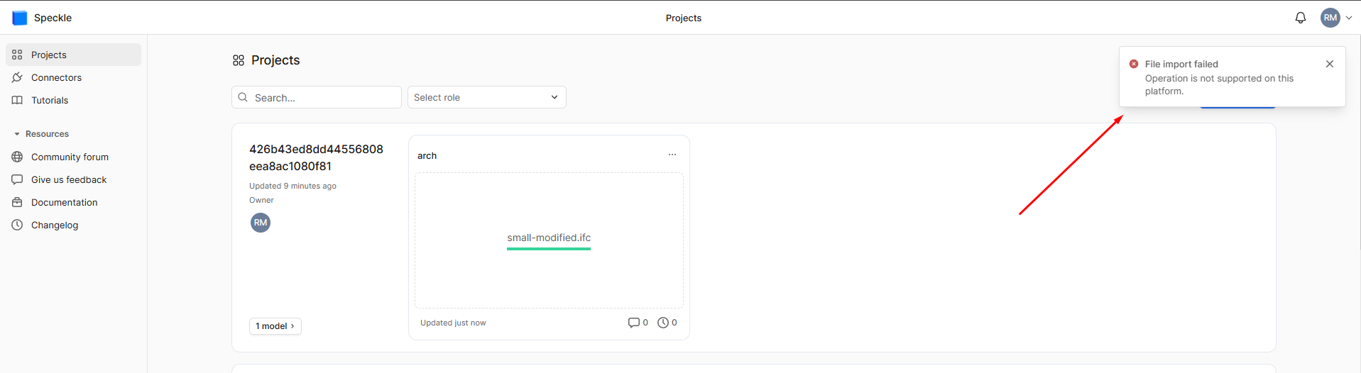

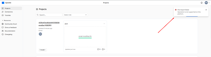

After updating all services to version 2.23.16, the IFC import feature stopped working. Below is an image of the error.
It’s worth mentioning that I hadn’t updated the Docker Compose version in a while, so this issue might not necessarily be tied to version 2.23.16 . In fact, I rolled back to version 2.23.15 , and the same error persisted.
Looking into the issue, it seems the logic has changed. When I try to upload the same file but add .legacyimporter.ifc to the end of the file name, it works fine.
My question is: did I misunderstand something? Is this import service no longer available for self-hosted setups?
Attached are the IFC file used in the example and the logs from the file-import-service for reference.
