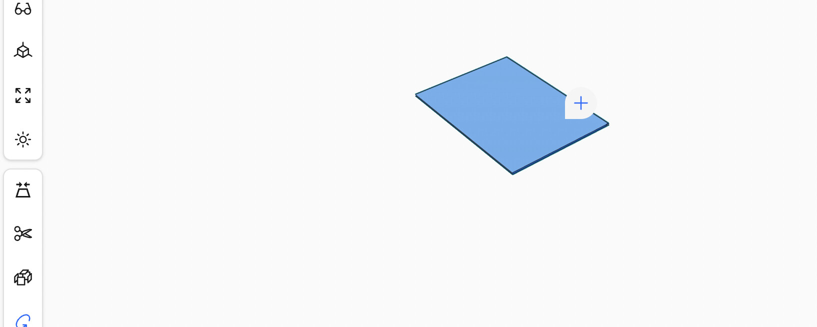

it seems that the secion box cannot be undone with the latest update of the server. Happens also on your app.speckle.systems and not just on our deployment.
  • Create section box via selecting and hitting the button
  • click on the section box button again to switch it off
  • section box stays despite button inactive again

We’re already tracking this issue and we know it’s annoying. A workaround until it gets fixed is to move the section box a bit. A button will appear in the bottom-middle of the screen which you can then use to disable the section box.
The ‘scissors’ button acts more like a show/hide section box rather than enable/disable at the moment. But we’ll give it a proper fix soon
