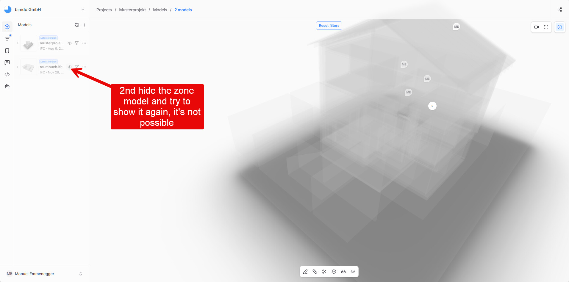

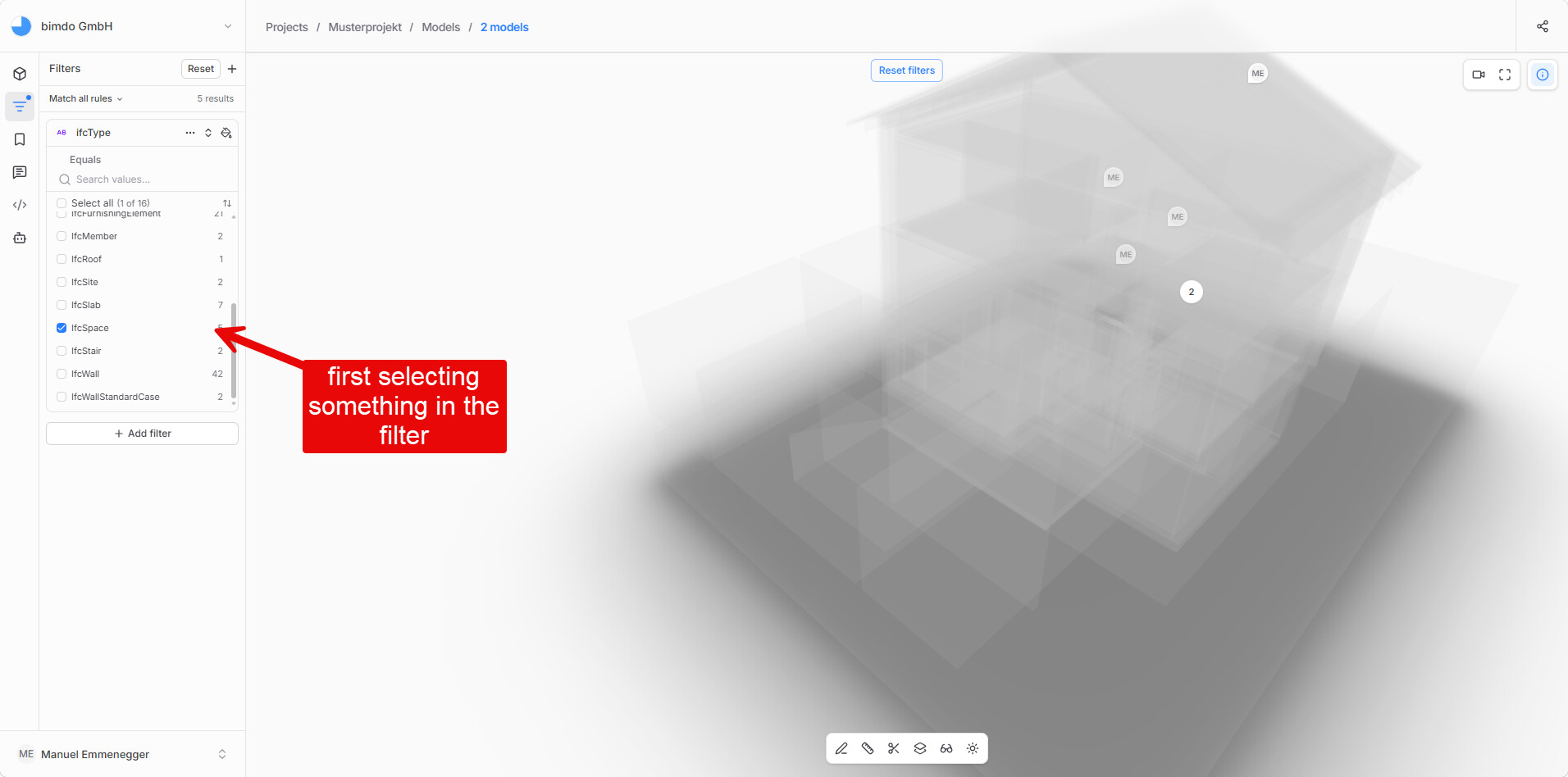

standardize filter
It seems, that hiding of a model is creating an issue with the filter and opposite. When you set a filter and afterwards hide a model, you won’t be able to make it visible again.

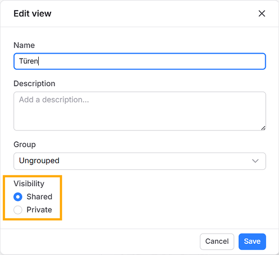

Sharing filters with project members
This is possible when creating or editing a view:

Problems with object visibility when applying a filter / view and then hiding a model
This one I can confirm; If I apply a filter or a view that has applied filters and then hide the model, I can’t un-hide the elements (or the model) without resetting the filter first. @dimitrie possibly a bug?

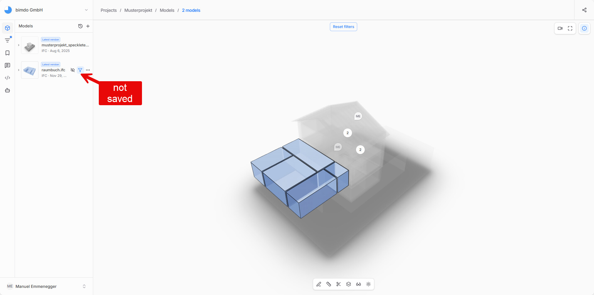

filters vs. isolation
My explanation was bad, there’s a button which is looking like filtering, but actually has the name “isolate”. This way of filtering/ hiding won’t be saved in the views.
