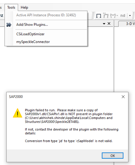

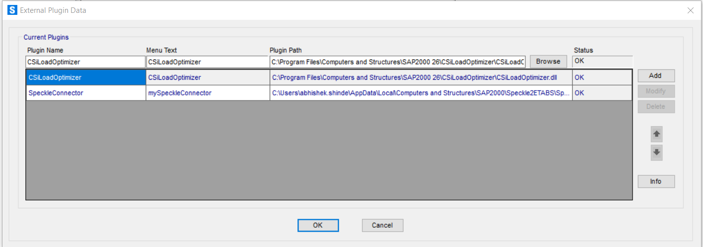

I am trying to test a workflow with Speckle and sap2000. I have also added the dll path to the plugins folder as shown in the first image below.
However, when I try to load the plugin, I get the following issue (in the second image). Could someone please help me with this? I checked there is no copy of the dll in the folder.

Hey @ashinde_TYL,
Thanks for posting this question. The SAP2000 v2 Connector supports up to and including SAP2000 v25. If you have licenses for v25 give it a go there and let me know how it goes.
