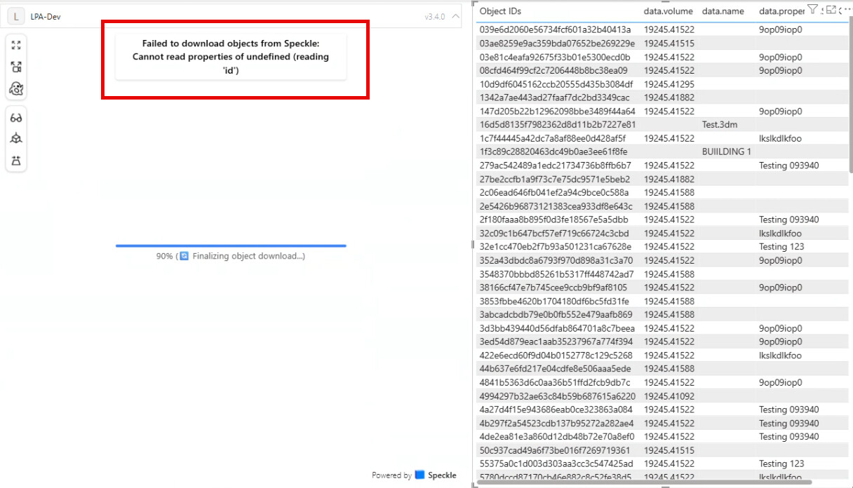

Having trouble getting the Speckle 3D visual to load a simple Rhino model test. I know the connector works because the data is available. I get error “Failed to download objects from Speckle: Cannot read properties of undefined (reading ‘id’)”
Rhino connector 3.9.3
Power BI 3.4.0
SDS 0.20.1
Any help would be appreciated!

Thanks for reporting this. I was able to reproduce the issue. We’re looking into fixing this. I’ll let you know once we release a fix.

We released a new version of Power BI connector that includes a fix for this issue:
