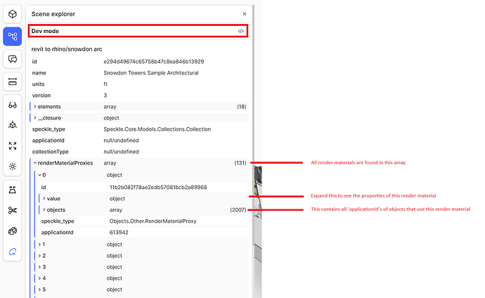

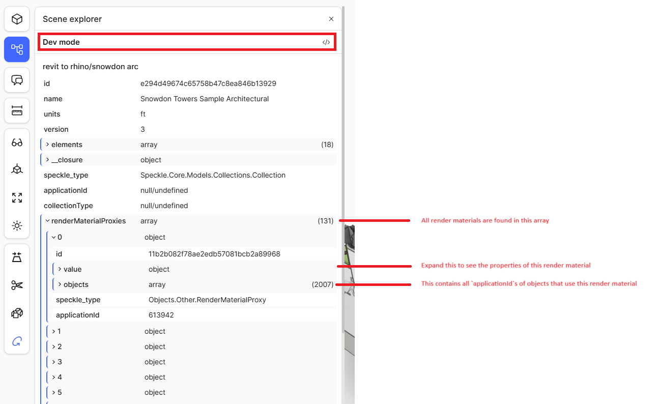

In the current connectors, you can find a list of all render materials in your model if you switch to Dev Mode in your scene explorer.
Expand the scene explorer
Click the Switch to dev mode icon: </> at the top.
Expand the renderMaterialProxies array near the bottom of your model
Each entry inside this array represents a single unique render material in your model. You can expand the value on the proxy to see the render material properties, and you can expand the objects array to see the applicationIds of all objects in the model that use this render material.
