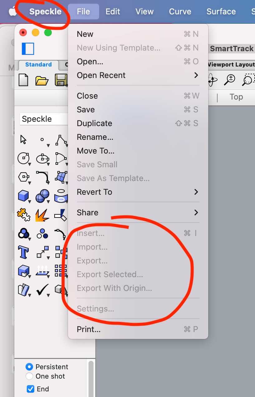

Installed a Rhino Mac connector last night. It works, but it replaces Rhino menu and all export options become unavailable.
I am on 12.3.1 MacOS
Using Rhino Version 7 (7.19.22165.13002)
Speckle Manager 2.2.6

Hi @artpen and welcome to the forum!
This is a known bug and we’re working to resolve it, maybe @AlanRynne knows a temporary workaround?

Hi there, experiencing this issue too — even after uninstalling speckle and rhino, when I reinstall rhino the issue persists. Is there a solve for this or is this a permanent issue until there’s a solution?
Thanks,
Hey @4d-Studio and @danielrous ,
This issue has been fixed in 2.9.2, can you please give it a quick try? Appreciate it
